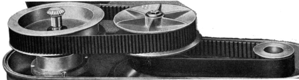

In its ordinary form the machine, as shown in the first illustration below, appears to have been specified with a single-speed 2.5 h.p. motor, this being flange mounted vertically at the back of the head. Drive ran forwards to the spindle through an expanding and contracting variable-speed mechanism that gave a speed range from 80 to 1800 r.p.m. However, a number of confusing options were listed including the incorporation of an oil-bath lubricated, lathe-like backgear assembly using hardened CrNiMo gears that, while offering usefully  increased torque when in use, did not reduce the slowest speed - the range remaining exactly as before. In addition the makers listed a 2-speed 2.5/1.1 h.p. motor that, presumably available with or without the optional backgears, gave a range with lower speeds down to 35 r.p.m., yet no higher at up to just 1800. Other versions had their motors mounted vertically beneath the head - in the style of a conventional drill press - and are thought to have had an ordinary V-belt drive, though doubtless with a very similar speed range.

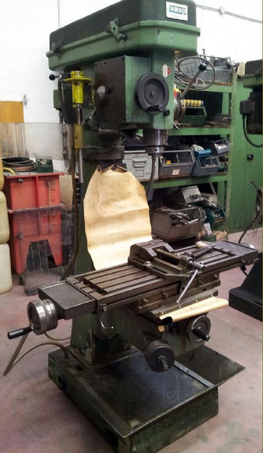

Famup Type TCSV with it's the vertical slideway formed as a boss on which the knee could be rotated. Note the twin support struts necessary to brace the overhung knee. This version of the machine had a table able to be swivelled on its vertical axis but not tilted fore and aft
This table assembly had a most unusual (possibly unique) configuration that not even a Deckel-type universal miller could achieve: the arrangement was simple - the cross slide carrying the table had a curved top that allowed the latter - controlled by fine-feed worm-and-wheel gearing - to be tilted backwards through 90° until it stood vertically. or forwards though 55°. The same table, but carried on a knee that could also be rotated, was used on the Famup "Unimilla"
A version with the tilting table but with its motor mounted beneath the head and a fixed knee elevated by a conventional front-mounted screw
This model lacks the front-to-back tilting table yet retains the cantilevered knee and so the ability to swing the whole assembly on its horizontal axis
Expanding and contracting variable-speed mechanism that gave a speed range from 80 to 1800 r.p.m.
