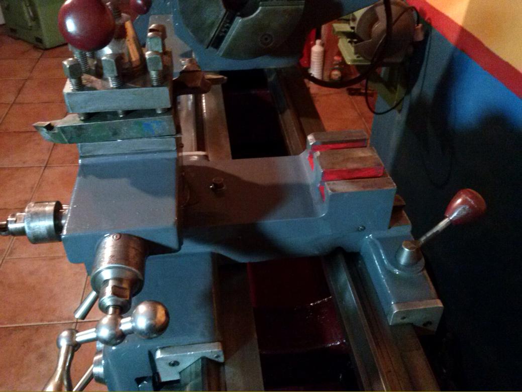

Of conventional arrangement, the compound slide rest had a cross slide formed with a very small T-slotted section at the rear and a top slide, that could be swivelled through 360°, fitted as stadard with an indexing 4-way toolpost. Micrometer dials were rather small and the feed0-screw handles of the traditional "balanced" type.
A lack of concern for the operator was evident in the arrangement of the tailstock, this being locked to the bed by the use of a loose, self-hiding spanner instead of an eccentric cross shaft and captive handle.
