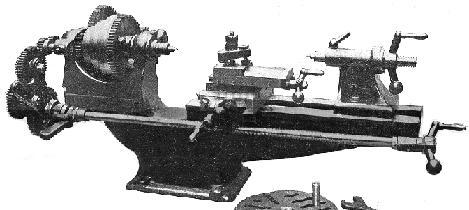

One of the ETA lathes that remains a mystery as to its type number is a rather superior machine with an overhung carriage-feed powershaft, driven from the headstock end of the leadscrew and intended to provide a sliding feed along the bed without wearing out the clasp nuts. An illustration is at the bottom of this page.
