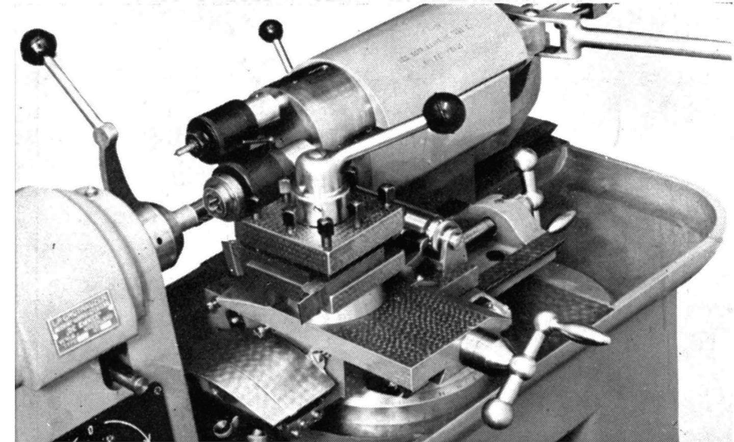

Of unusual design for a small production machine, the indexing cutting and threading tools were carried not by the usual type of bed-mounted rotating turret, but in a massive, patented tailstock that could be specified with either four or six No. 2 Morse taper holders formed in the end of its large diameter, rotating spindle. The stroke, driven by a long handle, was 4.375", with each holder having its own screwed stop and indexed round in the usual way to line up with the headstock spindle. If required for conventional between-centres work, the spindle could be locked.
If the lathe was intended for just for simple boring or drilling jobs (though at a very expensive £575 in 1952 this would have been a hopelessly uneconomic proposal), a much lighter, ordinary No. 2 Morse taper single-spindle lever-action tailstock was offered in lieu of the capstan version.
A 4-way toolpost was fitted as standard, its mechanism being cleverly designed so that one-handed operation was possible - a one-quarter turn of the handle rotating the next tool into position and locking the unit down. As an additional refinement, as the toolpost turned it was not lifted, so avoiding the ingress of swarf and dirt..
Instead of the expected simple cut-off (forming) slide, the Emwee was equipped with a conventional form of compound slide rest - though the details of its arrangement construction were far from ordinary. Costing an extra £40 (only a little less than a complete backgeared and screwcutting contemporary Myford ML7 lathe) it was mounted on and able to rotate about a separate circular boss fitted in front of the bed - the whole assembly able to be slide along for a short distance and locked down by a through-bolt with the clamping levers emerging from the underside of a recess in the centre of the stand. The slide rest had 7 inches of longitudinal travel, 5 inches across and could be had in various specifications with either all-screw or all lever feed or fitted with a capstan-handle-operated longitudinal feed with a combination screw and lever-feed cross motion.
Compound slide assembly with lever-action feeds. The cross-feed could be operated by lever or screw - a small toggle handle being provided on the right-hand side of the slide to lock the lever when the screw was in use.
