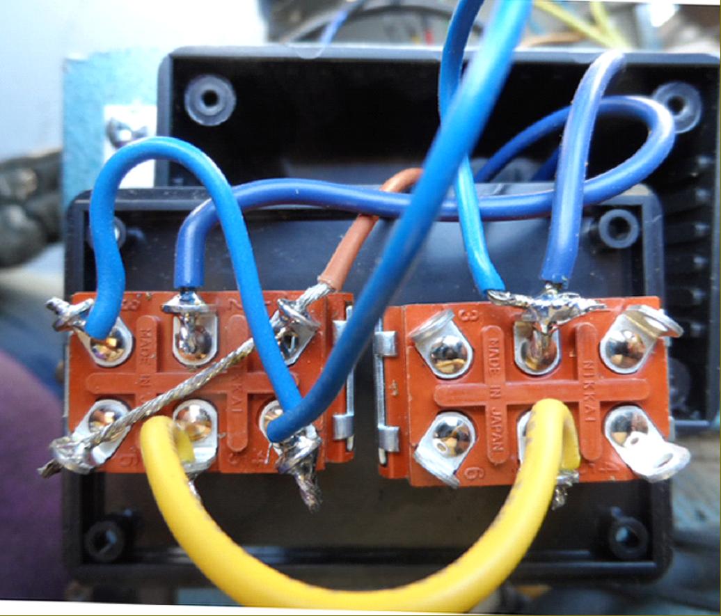

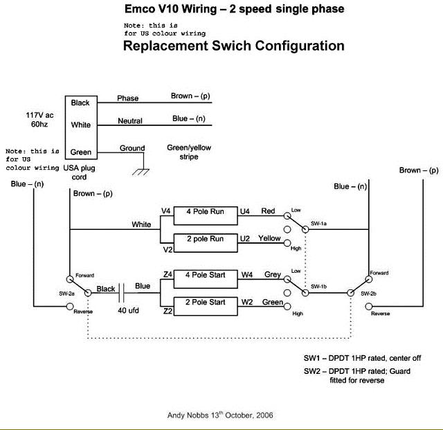

Photographic Record of Replacement
2-Speed switches Being Installed
Note: this is a set of pictures taken of an installation in the United States. It may well be that the colours of wire used are different in your country. To save expense and danger, IT IS ESSENTIAL TO HAVE ANY INSTALLATION YOU ATTEMPT CHECKED BY A PERSON SUITABLY QUALIFIED IN THESE MATTERS
