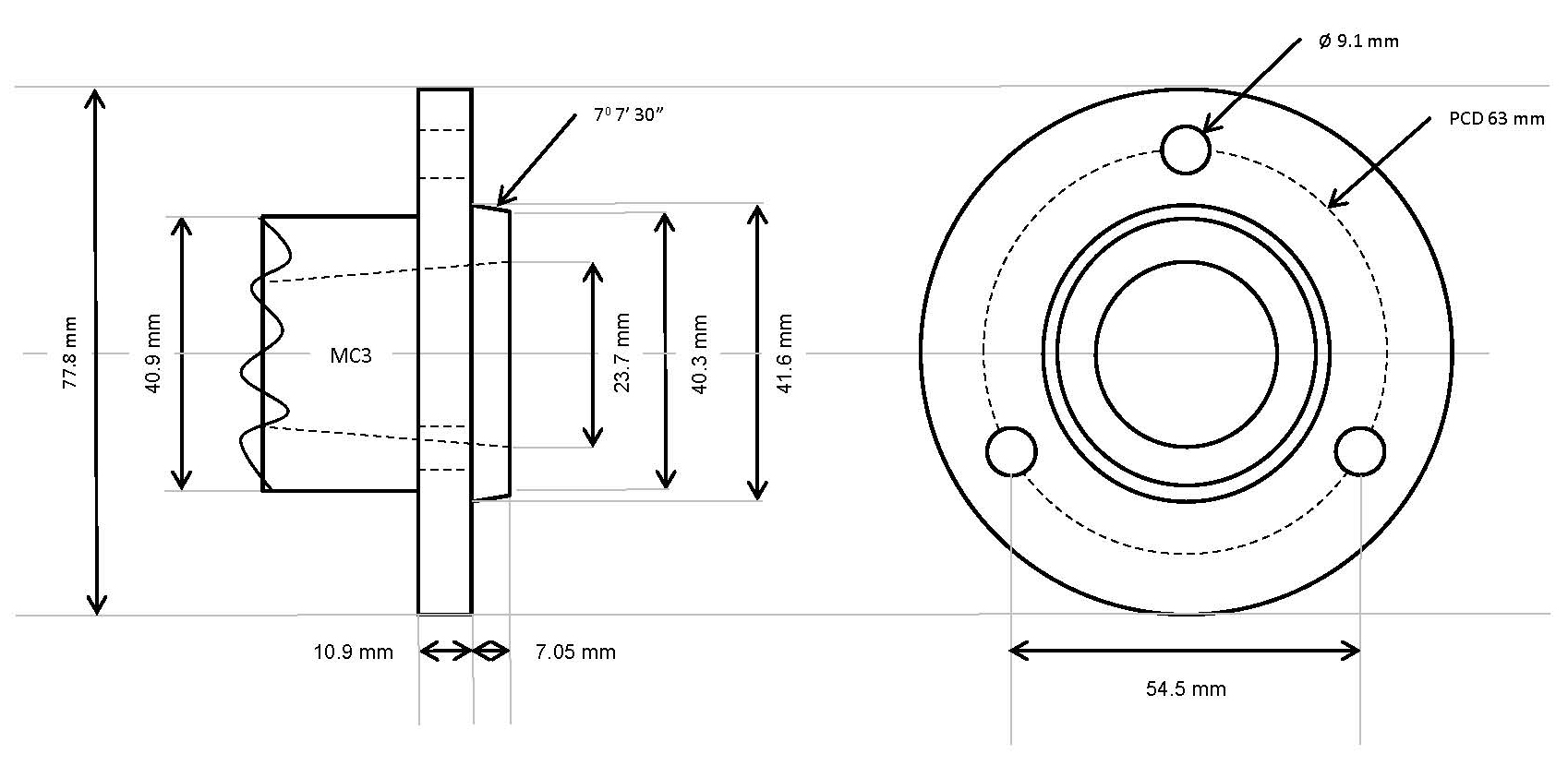

Cast as a very stiff closed box, the bolt-on headstock carried a 20 mm bore spindle running in two adjustable taper roller races with a drive pulley overhung on its left-hand end. The spindle nose was a safe but inconvenient "Emco special", similar to DIN 55021, with three holes on an integral flange with a short taper to locate fittings accurately - a drawing, taken from measuring on a lathe, can be found towards the bottom of the page. Chucks and other fittings had to be unbolted, a slow and awkward process and, as a plain backplate was never amongst the accessories listed, owners were tied to using original and expensive Emco parts.

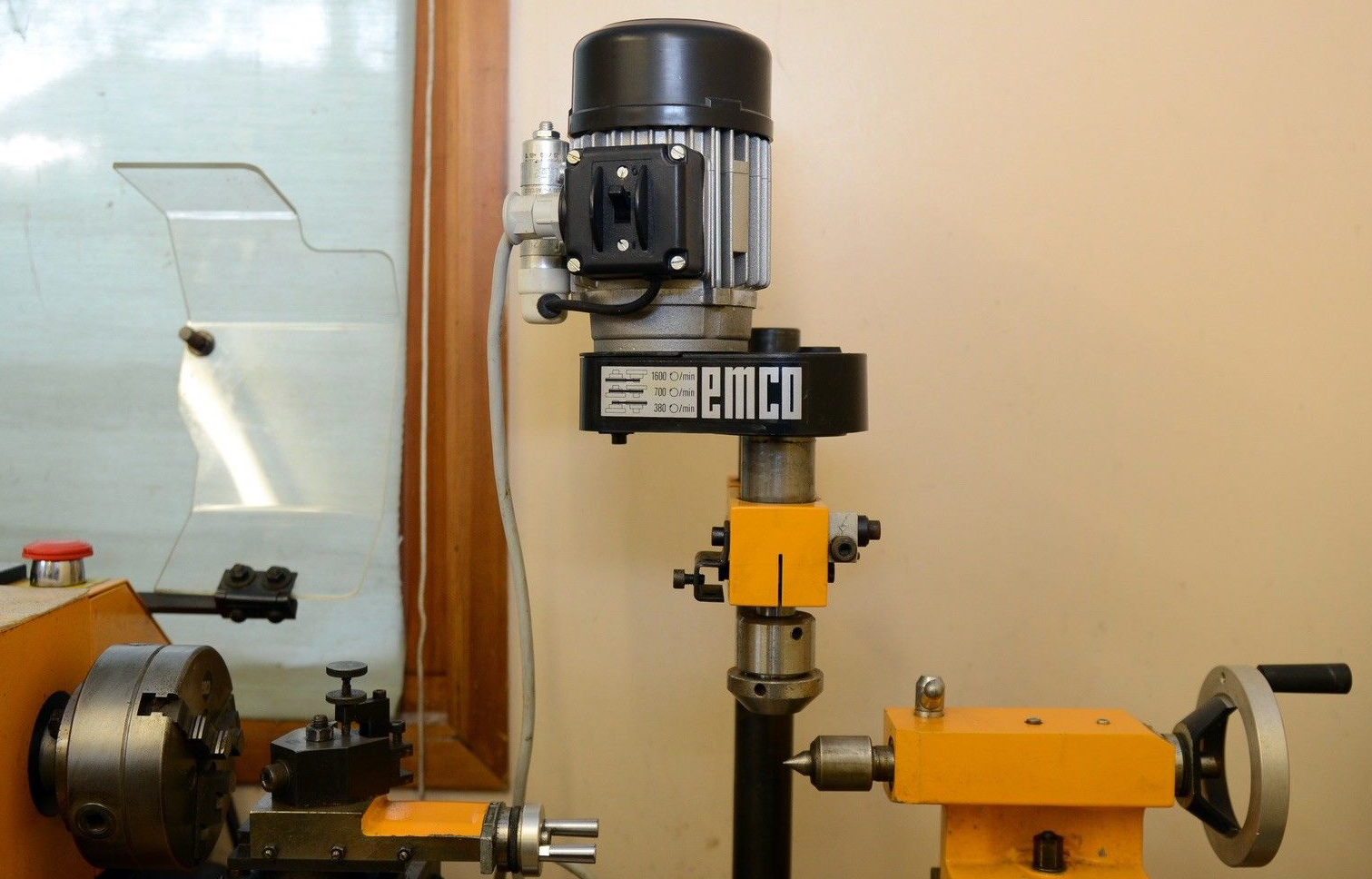

Emco Compact 8 on the correct maker's stand and fitted with a  motorised vertical milling attachment - also used on the Compact 5. The milling unit is shown with the optional fine-feed attachment (the "aluminium box" on the right-hand side of the head)

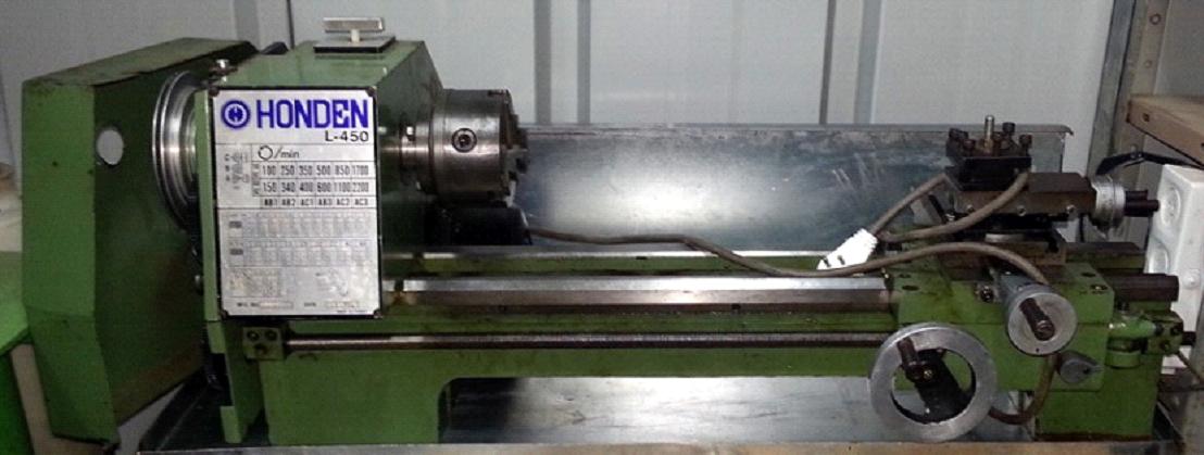

The Emco Compact 8 was widely copied in the Far East. Some versions were identical, other modified in a variety of ways - even to the extent of fitting a screwcutting gearbox with a limited range of pitches.
One problem often encountered on these machines is a short life for the narrow, 5 mm drive belt. The belt is tensioned by a lever-operated jockey pulley and, if this mechanism is not as well constructed as the original, will flex so causing the belt to run out of line and fail abruptly.
