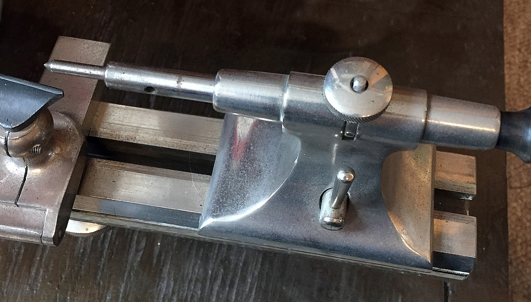

Although some examples of the Elson have been found in a black crackle paint finish, the one shown below is chrome-plated - whereas all genuine Leinen lathes were finished in a much duller and "softer" nickel plate. However, the possibility exists, of course, that it was refinished at some point post 1930 when chrome plating first became widely available.
Of the very popular WW (American Webster Whitcombe) type, a design introduced around 1889, the Elson, in its handsome plated finish, would have proved to be a rugged and reliable little lathe. The centre height of all genuine WW-type lathes was usually 50 mm, though very occasionally 65, 70 mm and other figures are encountered. Of heavy construction, the bed was formed with a 37 mm-wide flat on the top and a 60-degree bevel along each edge, and carried a headstock spindle to accept 8, 10 mm or 12 mm collets (though again, exceptions exist and odd, in-between sizes have also been found).

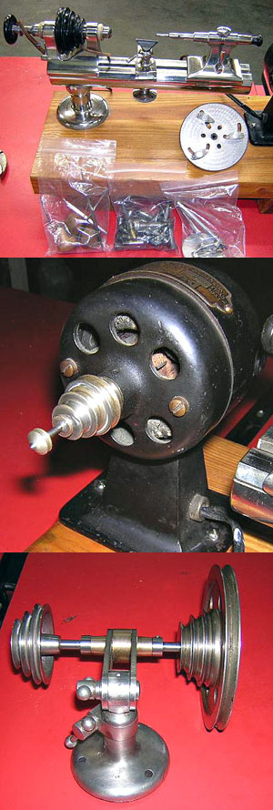

The same countershaft has been found with two examples of the Elson lathe
Above and below: found together with a number of Elson accessories, a Boley & Leinen faceplate
An Elson mounted on what is probably not an original maker's
"rubber insulated"  base plate but a third-part accessory by Borel
A collet that fits an Elson lathe
