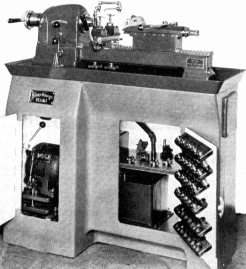

9" x 18"  "Elgin" Precision Turret Lathe of 1941 set up for production work and complete with coolant equipment, a lever-action collet closer and a  full compliment of collets mounted on the right-hand door.

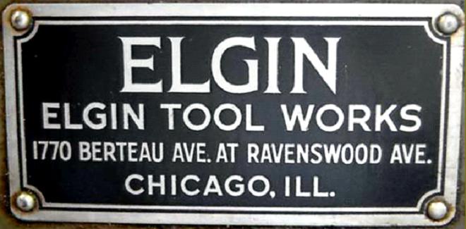

A 1930s Elgin machine tag showing ownership belonging to Franklin Harding's 1931-established Hardinge Manufacturing
