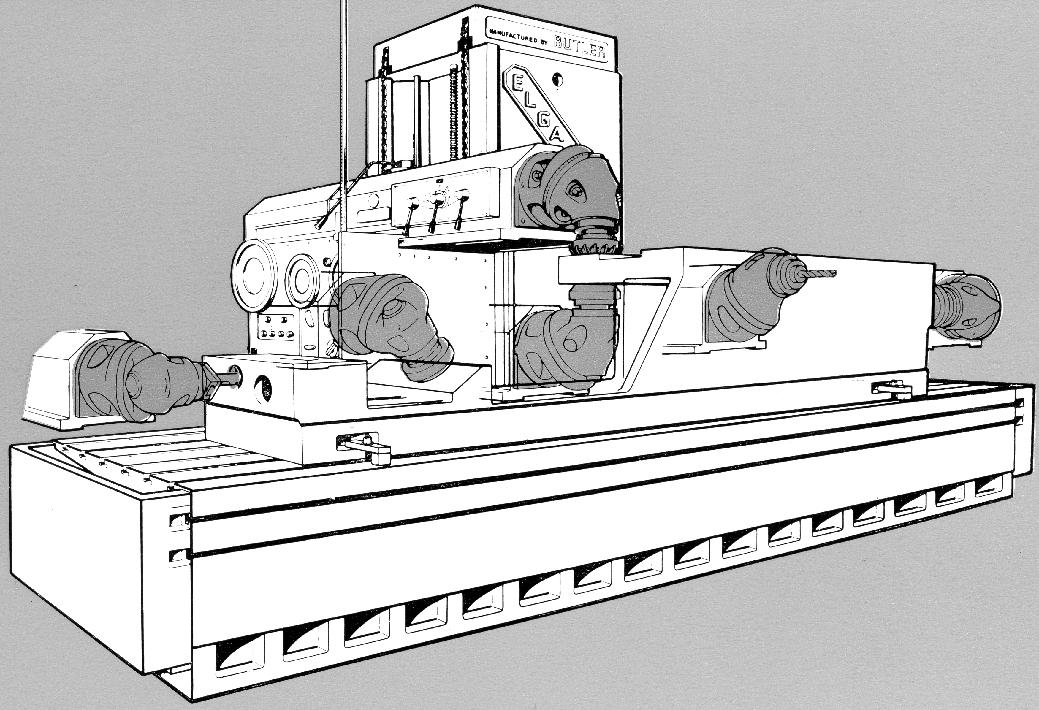

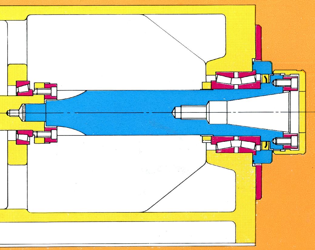

Section through the horizontal spindle. Running in two pairs of pre-loaded precision bearings, the spindle was driven by a motor that could - depending upon the size of the miller - vary in output from as little as 10 to as much as 40 h.p. From the flange-mounted motor, drive passed through oil-immersed gearing and a mechanical clutch on the smaller CS8 and CS10 models but a heavy-duty, electro-mechanical clutch on all other variants.

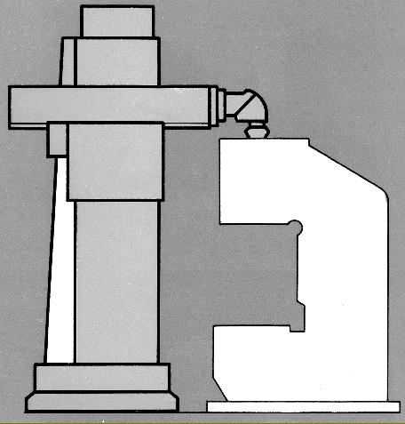

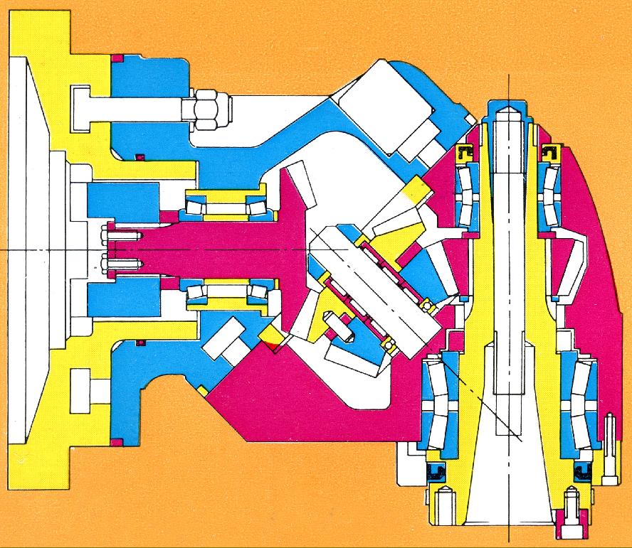

Section through the Universal Head showing the pre-loaded double-taper roller bearings. On the High-Column model these bearings were listed as being of the very much more expensive, high-precision Gamet - presumably in place of ones having an ordinary level of accuracy.

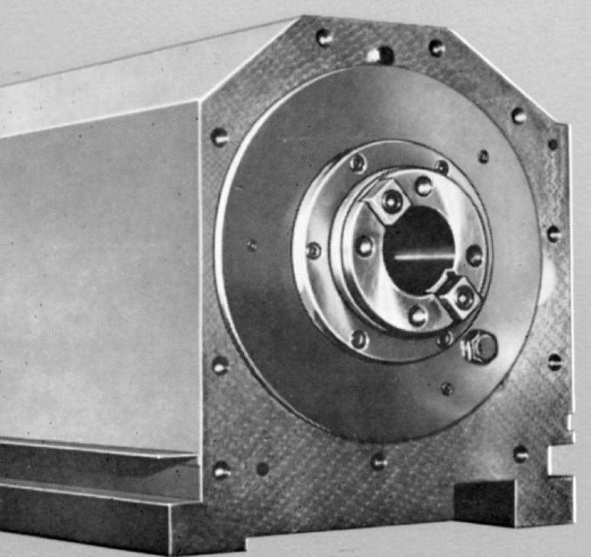

To help support the column's weight a set of recirculating roller bearings were fitted beneath it, these running on hardened steel tracks.

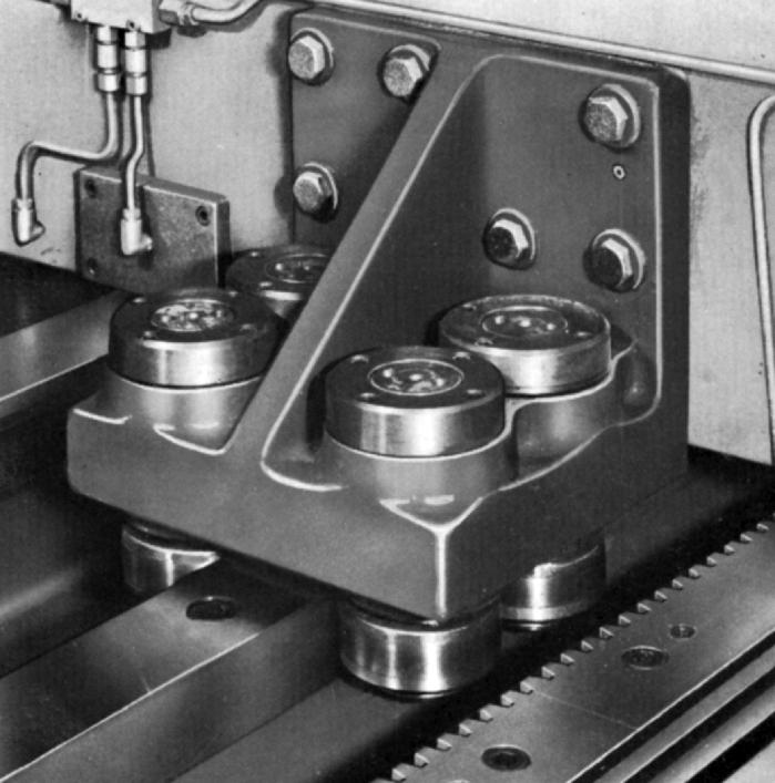

Longitudinal guidance was provided by rollers, these being of the pre-loaded type that engaged with ways of hardened steel

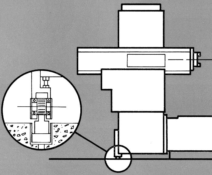

Section showing the longitudinal guidance of the saddel
Table drive system for the 15 h.p. Elgamill Type T travelling table model
