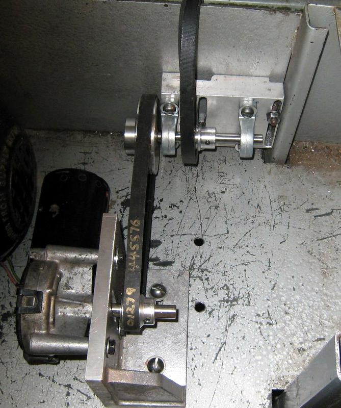

Continued: After some thought a tumbler-gear system was installed to drive the leadscrew; unusually (and ingeniously) this was placed on the right-hand side of a metal plate fastened to the headstock end of the bed. In addition to the usual forward, neutral and reverse this novel arrangement allowed a stub 'leadscrew' to be placed about 2" lower than the actual leadscrew, thus making space for a standard Myford 'banjo' and changewheels. To avoid the necessity of having to use metric conversion changewheels the leadscrew was cut 10 t.p.i (Acme form) and, as 10 t.p.i = 2.54 mm, this was considered near enough to 2.5 mm pitch. When the first metric screwcutting job was tried - a 0.5 mm thread - the builder was delighted to find no detectable error over a distance of several cm. In addition to the changewheel drive a separate power feed was been arranged to the carriage using that old favourite - a car windscreen wiper motor controlled by a variable resistor. The motor was mounted on a shelf, beneath the lathe, to drive via speed-reducing pulleys to a small countershaft. The drive them passed upwards (again through a pair of step-down pulleys) to the tailstock-end of the leadscrew. This arrangement gave that most desirable of effects - normally only available on an expensive toolroom lathe like the Hardinge HLV-H - where a precise sliding speed could be set for a particular combination of workpiece material, diameter and spindle speed. A good deal of thought went into the compound slide rest. The result was exceptional: a unit with slides having generous travel, fitted with large and clear micrometer dials and, with closely-spaced gib-strip adjustment screws, a silky feel with no loss of rigidity. The first toolpost used was an home-made "Norman Patent" type (as employed for many years on Drummond M-Type lathes) - a block of steel, split on one side, that dropped over a central pin and able to be locked at any height. This was replaced by the central part from a simple but effective commercial quick-set type - for which a large batch of extra toolholders was then manufactured. For a delicate touch when drilling a lever is far superior to a thread - and so the tailstock was constructed with its No. 1 Morse taper spindle driven by rack-and-pinion gearing controlled through a 3-spoke capstan handwheel. Arranged so that it sat underneath the barrel (in order to pass though a greater mass of material) a spindle lock of the proper (and powerful) split-barrel type was chosen. A further advantage of this location (as used on the Myford ML7) is that it removed the need to incorporate a boss on the back of the tailstock body to hold the lock, though there remained the slight inconvenience in having to reach over to operate the lever..

The windscreen wiper motor (bottom left) driving by speed-reducing pulleys to a small countershaft - all mounted on a shelf below the lathe. The right-hand belt (also by speed-reducing pulleys) drives upwards to the tailstock-end of the leadscrew.
