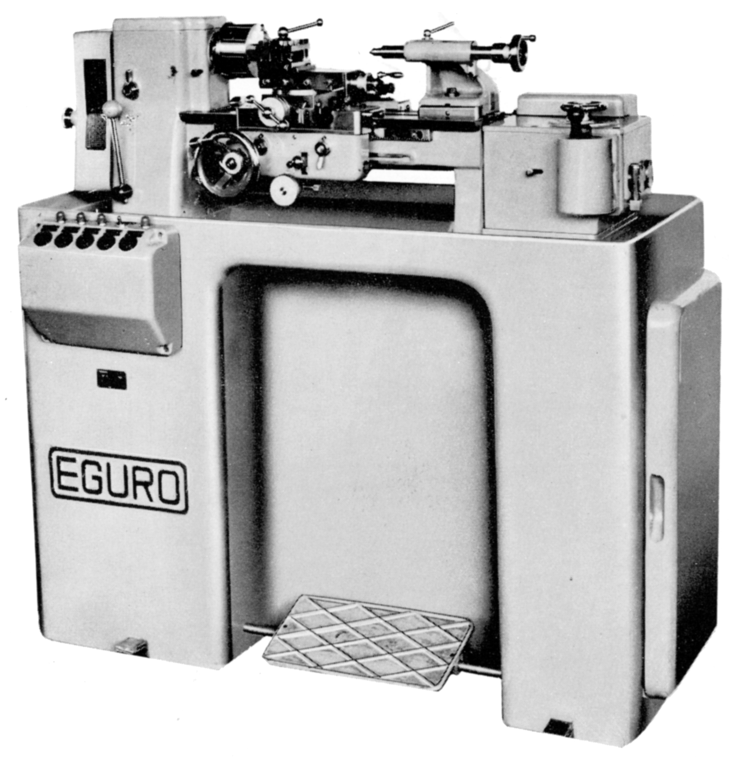

Manufactured by the Eguro Iron Works ltd. With works and offices at 3181 Narita-cho, Okaya City, Nagano Prefecture in Japan, Eguro lathes are little known outside their native country. Built in a range of small models that mirrored those by makers such as G.Boley, Leinen, Schaublin, Wolf Jahn in Germany, Schaublin in Switzerland and Hardinge in the United States, Eguro produced both screwcutting and plain turning models for toolroom and small-batch production work. Conventional, non-CNC Models traced to the makers from the 1950s to the 1970s include the heavy, toolroom class 120 mm centre height GL-120, the smaller stand-mounted screwcutting EL-2 and EL-3, various simple plain-turning types similar to the PH6L-3 and a pair of unusual bench milling machines, the TF-5 and TF-6.
Eguro EL-2
Most likely to be found of the Company's lathes made from the 1950s until the 1970s is the 90 mm (3.5") centre height by 300 mm (12") between centres Model EL-2 - a lathe designed both for one-off precision work but also arranged for ease of use on production runs. Constructed in the form of an open-topped box with a hinged lid, the headstock casting was hand scraped to a perfect fit on the bed and held a 19.5 mm bore spindle made from heat-treated, high-carbon chrome steel running in bronze bearings. Lubrication to each bearing was by a copper tube, neatly recessed into the top face of the casting and fed by gravity from oil-cup reservoirs mounted at the back of the headstock.
Fitted with a screw thread, the spindle nose was also machined to take EDA No. 6 collets with a 30° seating, a set of seven being supplied with each new lathe with through capacities from 8 to 14 mm. Fitted as standard was a lever-action collet closer, the long operating handle pivoting from a boss low down on the front face of the headstock with the linkage passing through the headstock to a series of pivoting links at the rear. A most useful fitting (absent from so many lathes) was a pin that protruded from the face of the headstock by which means the spindle could be locked to ease changes of nose fittings.
Power came from a standard-fit, 2-speed, 0.75/0.25 kW large-frame motor mounted on a plate, hinged vertically for belt-tension adjustment inside the left-hand section of the all-cast-iron stand. Fitted to the motor pulley was a 4-step "A" section V-pulley that drove upwards to a ball-bearing supported countershaft with its rotating parts all balanced - final drive to the headstock spindle being by another "A" section V-belt. Spindle speeds (on a 60 Hertz supply) ran in low range from 400 to 500, 700 and 900 r.p.m. and in high from 1100 to 1500, 2000 and 2600 r.p.m. As an option, the lathe could be supplied with a single-speed motor and the drive arranged to provide either just the low or high range. As no backgear was fitted, the lathe would have been limited in its ability to take deep cuts on large diameters at lows speeds. However, even though the bottom speed was relatively high, as the leadscrew was fitted an automatic trip mechanism, screwcutting (normally done at low speeds by the inexperienced) and work up to a shoulder could be accomplished at high speeds, even by a semi-skilled worker. Electrical control for the high and low motor speeds was by switches on earlier models but push buttons on later - both having stop and start control by a foot pedal. An automatic brake brought the spindle to a quick stop, this being triggered by a micro-relay when the power to the motor was cut. The electrical panel was built into the back of the stand, sealed against the ingress of dirt and accessed by a removable cover.
Screwcutting was by a set of 17 changewheels, working through a tumble-reverse mechanism fitted to the inside left-hand wall of the headstock, with the 3 mm pitch leadscrew, as on some other high-precision lathes like the Schaublin 102-VM and Carstens "D" Series, being set down the centre line of bed, beneath the ways, where it was completely shielded from swarf and dirt. Its position also meant that it was the minimum possible distance away from the cutting tool, almost directly beneath it and hence ideally placed to provide the most rigid form of drive. As the leadscrew buried was out of sight, the thread-dial indicator driven by a shaft fitted alongside the engagement lever on the lower edge of the apron.

Eguro 90 mm (3.5") centre height by 200 mm (12") between centres Model EL-2
Eguro  EL-2 basic controls

Heavily cross-ribbed between its walls, the 680 mm (26.8") long bed was a remarkable 130 mm (5") wide, age seasoned and hand-scraped on its ways - these running for a short distance in front of and behind the headstock. The ways were flat on top and V-edged, the carriage running on a front and rear pair, the tailstock sharing the same rear but also having a separate third V-edged way set between the bed's front and back pair. As an indication of the lathe's high quality, the felt wipers fitted to each wing of the saddle were held not in cheap steel pressing but large bronze castings.
Enormously long, the 220 mm (8.7") travel carriage was almost half the length of the bed with the cross slide positioned, for best possible support, exactly on its centre line; thus positioned, the previously-mentioned extension of the bed ways in front and behind the headstock allowed the cutting tool to be brought right up to the spindle nose. An interesting feature at the back of the carriage was what appears to have been a powerful, lever-operated over-centre arrangement to lock the carriage to the bed.
Beautifully constructed, the compound slide rest had wide, hand-scraped ways and large diameter zeroing micrometer dials finished in a non-glare satin-chrome finish. Each slide - and the saddle - was fitted with a number of spring-loaded, ball-type oilers (best attended to with a good-quality, lever-action oil can with a flexible spout pressed against a nipple together with an intervening piece of clean cloth to form a seal). The 80 mm (3") travel cross slide was provided with two short parallel T-slots machined into the rear section of the slide, their spacing being intended to allow a choice of where to mount a parting-off toolpost. Fitted as standard to the 70 mm (2.75") travel top slide with its ability to be rotated through 360°, was a 4-way toolpost, it's correct alignment with the slide being assured by a very clever, probably unique, spring-loaded pop-up catch positioned in the far right-hand corner of the slide's top face. The catch was machined with a sloping top surface and a vertical flat so that, as the toolpost was rotated, it passed over it and was pressed down but, as soon as the rotation was complete, the slide popped up and the toolpost could be turned back so that it registered against the flat. It appears, from the specification sheet, that a simple "clog-heel" type toolpost might also have been provided as well.
Surprisingly for a small lathe of its type, the EL-2 was fitted with power cross feed, engagement being by pressing down a snap-action lever protruding from the apron and disengagement by a small chrome-plated lever above it and to the right.
Fitted with a No. 1 Morse taper socket, the tailstock could be set over for the turning of slight tapers and, typical of the type found on precision bench lathes with a very long travel spindle but, in addition, and not so common, a zeroing micrometer dial.
Supplied as standard with each Eguro EL-2 was a headstock spindle sleeve adapter to take a No.1 Morse centre; a 4-way toolpost; a tailstock No. 1 Morse centre; a lever-operated collet chuck and seven collets with bores from 8 to 14 mm; 17 screwcutting changewheels; a catch plate; a box spanner and six ordinary spanners.
Accessories included a rather unusual (possibly unique) carriage stop in the form of a steel block fastened across the bed and drilled with five holes into which could be fitted bars with, on their ends, a hinged section that allowed each to be brought into play as needed; other collets of various bores; a taper-turning attachment; cone and fir-tree collets and 3 and 4-jaw chucks.
1080 mm (42.5") long, 400 mm (15.7" ) wide, the Eguro EL-2 stood 920 mm (36") high and weighed 400 kg.
