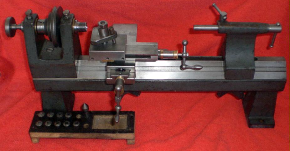

The three watchmakers' lathes shown on this page are by unknown makers from the former communist-controlled East Germany (the German Democratic Republic - GDR and DDR). All exhibit unusual aspects of design, with the robust, black-finished 10 mm collet model having a bed with a narrow, flat top surface and steeply angled side faces each being machined with a full length rectangular groove to locate the slide rest and tailstock.

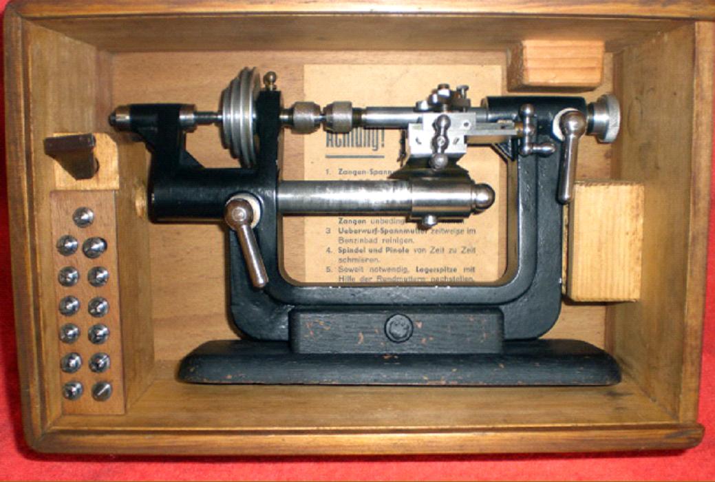

Surviving in its maker's box together with a collet set, the smallest of the three had its base, headstock and tailstock cast as-one in the form of an elongated letter "U". The swivelling compound slide-rest was held on the end of a round bar that slid into the headstock casting immediately below the spindle - the latter being of the simple type running in just a front bearing with its outer end supported against and adjustable hardened-steel point. As the tailstock casting was fixed, a long-travel spindle was provided - this, lacking a screw or lever feed, being slid to and fro by hand.

10 mm "Unbekannter Feindrehstuhi" with its unusual bed design
