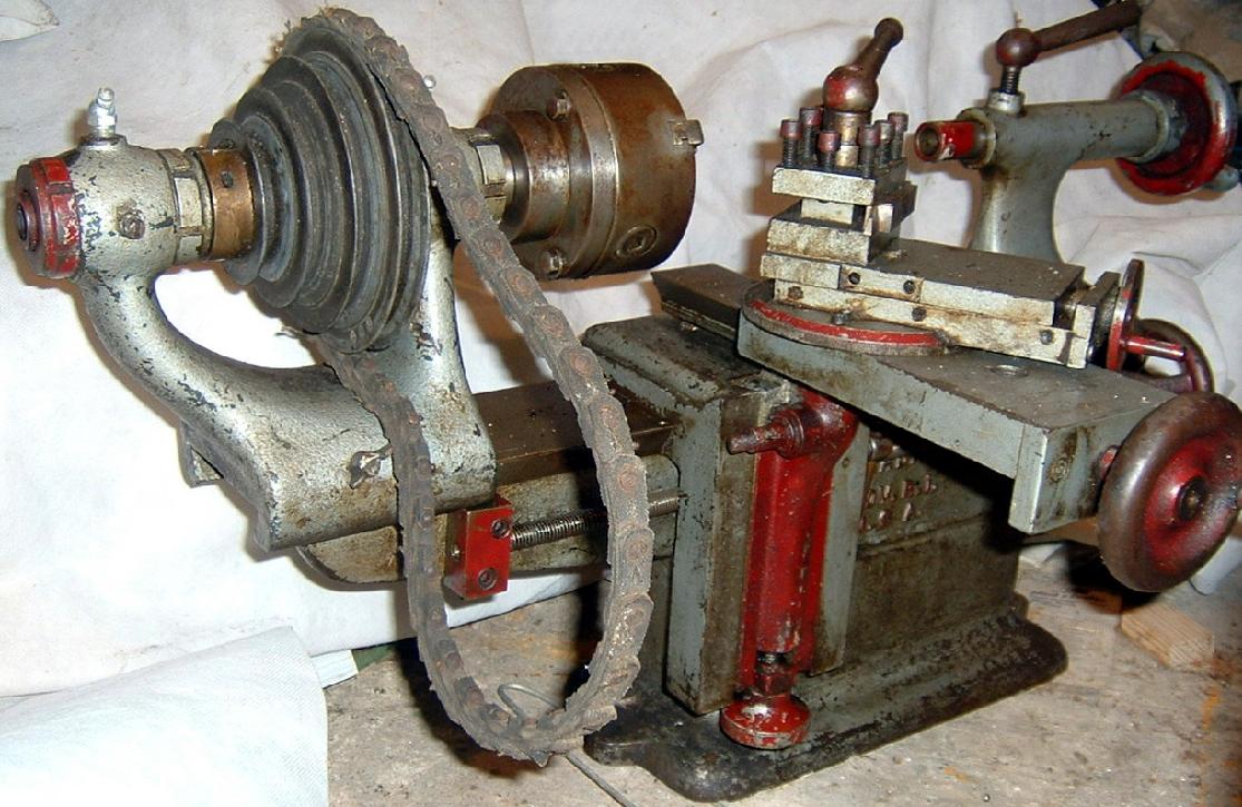

Providence, Rhode Island, was home to many makers of machine tools with grinders by Leach and the Builders Iron Foundry and several lathe makers, including E. A. Eddy, E. A. Adams, Adams Bros, the Diamond Machine Co.; E.B. Bosworth, Charles A.Mann, J.M.Parker's Gage, I.H.Spencer and Narragansett. Unfortunately, apart from Diamond, little is known about the historical background of any others, the record being, for the moment, blank. While the simple, plain-turning Adams Bros. Lathe would have been made around 1870 to 1880 and intended just for woodwork, the E.A. Adams machine was of very unusual design and of a somewhat later date, probably from the two decades spanning the 19th and 20th centuries. .
Of 4-inch centre height and 10-inches between centres, the plain-turning (non-screwcutting) E.A.Adams also lacked backgear but had its unusually wide, flat-topped V-edged bed formed from a good-sized box-section casting. However, in a reversal of usual practice this was cantilevered out to the left instead of to the right - an arrangement that would have offered the headstock somewhat reduced support. In fact, so odd is this construction that the writer believes the lathe may have been modified to accommodate the leadscrew - for some reason this needing a reversal of headstock and tailstock on the bed. Lending support to this idea is that an almost identical lathe, the E.B. Bosworth,  is arranged conventionally (the headstocks look to be interchangeable). If the arrangement is original then the slender tailstock, with its spindle clamp a crude, direct-acting screw, was better provided for and, when extended to allow the lathe's maximum capacity to be used, was only a little to the right of the main mass of the bed. The headstock, whose bronze bearings were threaded on their ends and, for adjustment, drawn down into their tapered seats by large ring nuts, continued the theme of "flexibility in construction" with the left-hand bearing held on the end of a slender arm and the right on top of a short, un-braced vertical post.  On the lathe illustrated, the headstock pulley looks to have been change for one in Zamak, as originally fitted, for example, to the 10-inch Atlas. The pulley may well have been, originally, identical to that used on other versions of the lathe perhaps with the same two wide steps and intended for industrial use - this arrangement being common on lighter and
bench precision lathes of the time (a similar 2-step arrangement being used on the headstocks of the W.H.Nichols and (three-bearing) Ames). Threaded on their ends for adjustment and drawn down into their tapered seats by large ring nuts, both headstock bearings were mounted in a light casting with that on the left held on the end of a slender arm cantilevered out to the left and that on the right on top of a short, un-braced vertical post
Although the makers were good enough to specify a compound slide rest this was, unaccountably,  carried on top of a vertical slide running in ways formed on the front face of the apron. Although this arrangement meant that the tool height could be quickly and accurately adjusted (by a very small-diameter handwheel) it brought in its train both expense in its manufacture together with even less rigidity between the cutting tool and workpiece.
Bereft of micrometer dials, the compound slide rest feed-screws gave very limited travel while their end-of-slide supports were simple flat plates - and not the type of extended  housing that would have allowed the slide extra travel by being allowed to pass over its ways.

Almost a mirror-image lathe of convention where, instead of the tailstock being cantilevered out to the right, the headstock was pushed out to the left into a position with little support.
No micrometer dials and the feed-screw end plates simple flat housings that abutted against the end of the ways to limit slide travel. The 4-step headstock pulley looks to have come from an Atlas 10-inch
The compound slide was carried on top of a vertical slide running in ways formed on the front face of the apron. A long lever was used to lock the slide once the tool height had been set.
