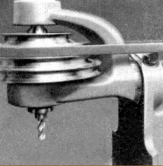

A serious omission on such a small machine intended for fine work was the lack of a quill feed on the head - any up and down movement of the cutter having to be made by raising and lowering the knee using a screw feed. As this feed was fitted with a crank-handle, rather than a full-circle wheel, control of very fine settings would have awkward. The head of the miller was graduated and could be inclined sixty degrees each side of centre - as well as moved in and out to a small extent.

Tilting the motor to aid speed changes.
