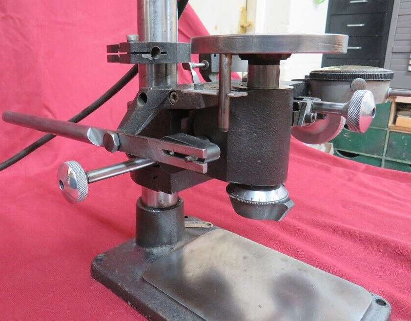

A very special Dumore precision drill press was also produced with a round table attached to a screw-feed driven compound slide assembly that allowed longitudinal and traverse movements. Each axis was fitted with a dial indicator and the table's elevation, by rack and pinion gearing, incorporated a micrometer depth stop with an especially large dial. For accurate spotting a microscope was also fitted. The unit, which might have been made by the English concern Kelston Engineering in Fishponds, Bristol (who built Domore machines under licence) was supplied to the Ferranti - once an important company prominent in power grid systems and defence electronics - and, in 1951, the maker of an early computer, the Ferranti Mark 1.

A very special Dumore precision drill press with a round table, covered with tapped holes, attached to a screw-feed driven compound slide assembly that allowed longitudinal and traverse movements. Each axis was fitted with a dial indicator and the table's elevation, by rack and pinion gearing, incorporated a micrometer depth stop with an especially large dial. For accurate spotting a microscope was also fitted. The unit, which might have been made by the English concern Kelston Engineering in Fishponds, Bristol (who built Dumore machines under licence) was supplied to the Ferranti - once an important company prominent in power grid systems and defence electronics - and, in 1951, the maker of an early computer, the Ferranti Mark 1.
