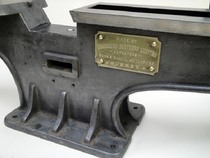

Stripped bed casting

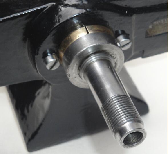

Spindle bearings & pull-in washers. This was the second design used - and much cheaper to manufacture than the first with its screw-on tightening rings
Headstock spindle

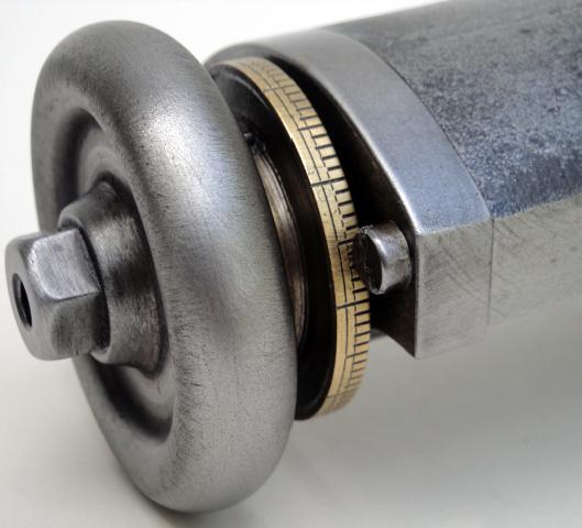

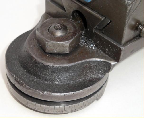

Complete circa 1906 tool slide with a home-made but usefully-large micrometer dial
As this early Drummond had only a single tool-slide the fitting of a
micrometer dial was an especially useful addition
In its ex-factory form both tool-clamp bolts would have been squared-headed
The tool-slide was secured by just a single bolt

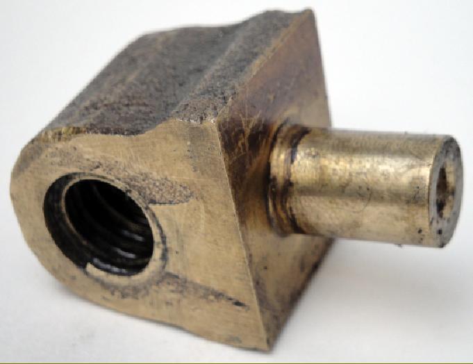

Leadscrew nut
