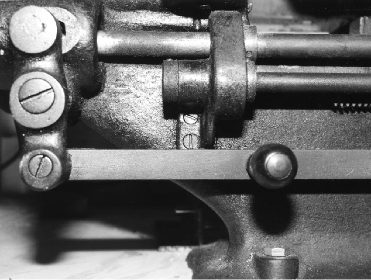

Power was supplied to the apron by a separate shaft, gear-driven from the left-hand end of the leadscrew.
Power-shaft drive gears

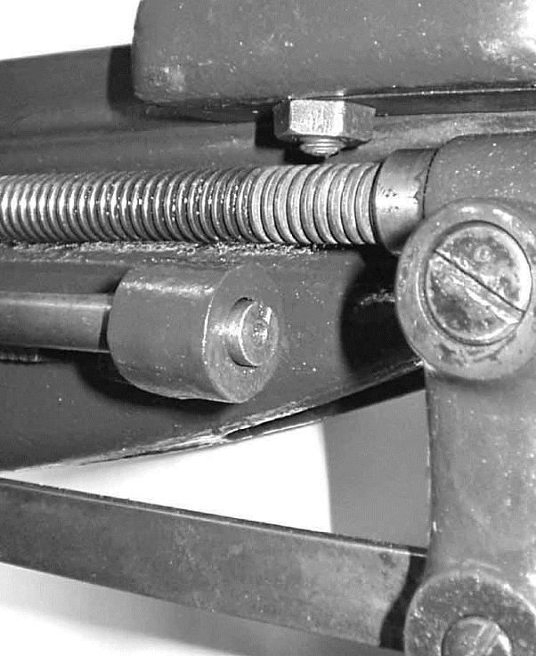

Tailstock end of the power-feed shaft
