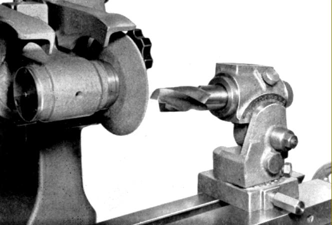

Able to be rotated through 180°, the wheelhead could, as a consequence, grind side and face cutters on their periphery and both sides at one setting. When the need arose to grind larger items, including saws up to 16 inches in diameter, a table-mounted "universal workhead" with a No. 4 Morse taper was offered as an optional extra.

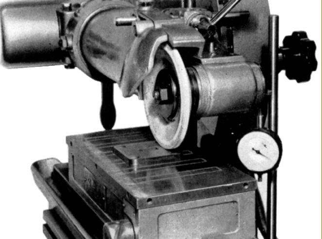

When set as a horizontal grinder - the maximum area able to be covered was 9 inches by 4 inches -  the top table was set in line with the lower, the usual magnetic chuck bolted in place and a dial gauge, to measure the depth of cut, attached to a vertical rod at the rear of the table's right-hand end.

Grinding a side and face cutter

Surface grinding
