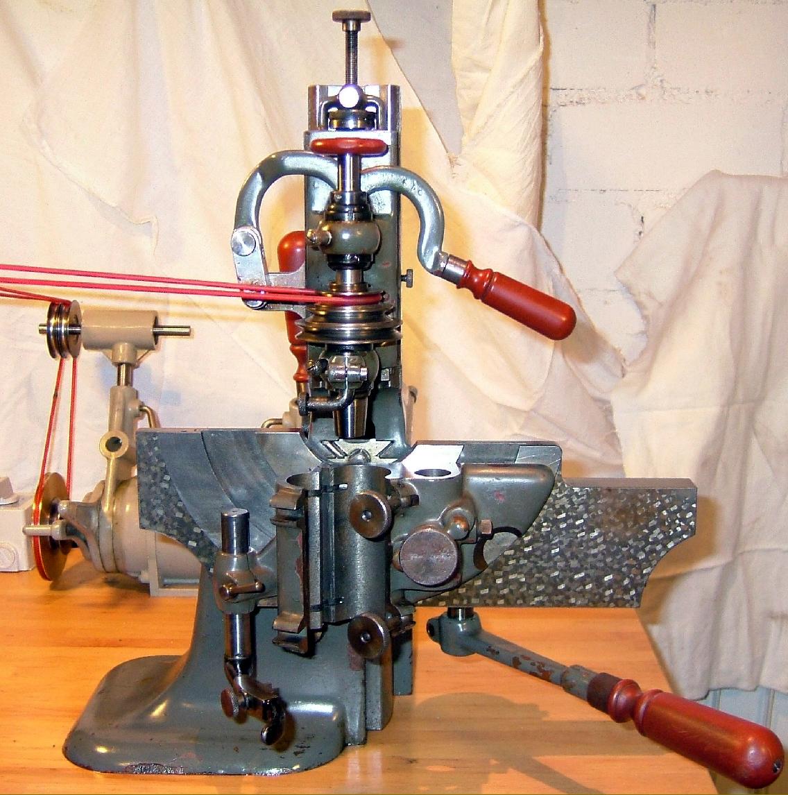

This wonderfully original and well-cared-for Dixi, almost certainly constructed as a machine for production work, was fitted with a vertical table to carry a spindle-holding unit that could be moved from vertical to horizontal. By adding a right-angle table, with a horizontal T-slotted top surface, the present owner has turned it into a far more adaptable and useful precision milling machine.  Continued
A version of the Dix able to perform in horizontal and vertical modes and equipped with a swivelling table and quick-release spindle unit
The standard machine with the head mounted on a vertical attachment

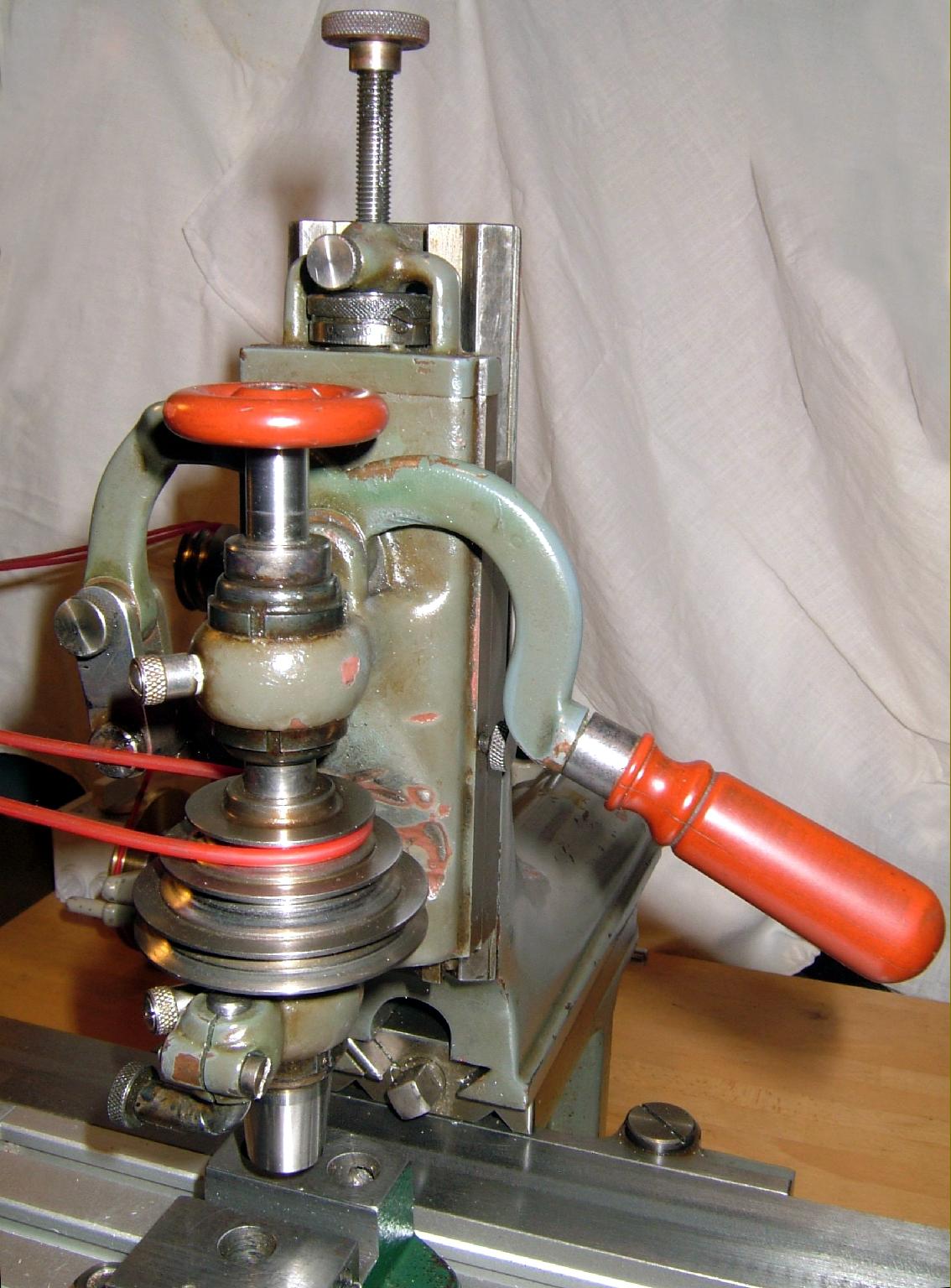

Lever-feed head mounted on the horizontal adaptor. Note the ingenious means by which the leverage was applied without the need for an  over-long handle.
Another view of the head's lever mechanism and micrometer stop
