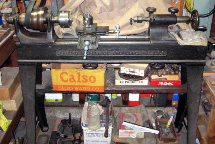

Of around 5-inch centre height and 28" between centres the "Diamond" lathe appears to have been a well-made industrial-class, plain-turning, non-backgeared machine intended just for simple work in metal - although it may also have been advertised as a lathe suitable for metal spinning or even as a brass finishers' machine. An unusual feature is what appears at first sight to be two clamping wheels on the tailstock spindle; however their function is not what it seems as there are, in fact, two concentric spindles - the larger driven by a lever for a quick feed and the smaller by the usual screw thread. The wheels are used to lock and unlock the former, the advantage being that in production use for spinning or brass finishing, the work can be swiftly removed and a fresh job inserted..
On the black-painted lathe below the lever assembly is missing, but the extension to the tailstock casting that provided the pivot point is visible - rather along the lines of the assembly also used on some Mikron lathes

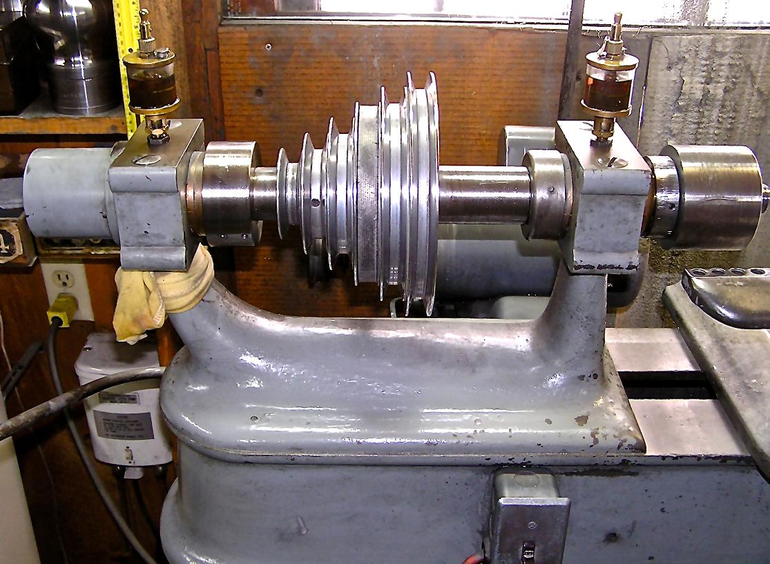

A long-bed Diamond lathe set up for  metal spinning - and in daily use for the manufacture of high-quality Pewter products This version was the largest Diamond made with the catalog listing it at a weight of 800 lbs and priced, with the optional 2-concentric spindle tailstock, at $125. A countershaft  assembly, as was common at the time, added a substantial amount, in this case more than the lathe at $145.
For simplicity and ease of use the original  4 or 5-step cast-iron flat-belt pulley has been replaced by a modern "A" section V-type
