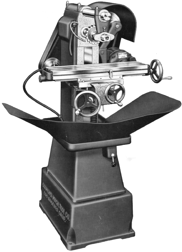

Standard version of the Diamond M-24 0n its neat underdrive stand. This model is fitted with a with screw-feed table and knee for general use - for production applications the table's X and Y movements could be lever operated.
