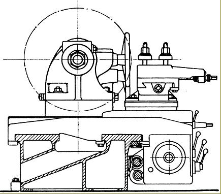

Special compound slide rest with screwcutting attachment for short threading or taper-turning work With the supplied changewheels metric, inch, DP and MOD pitches could be cut

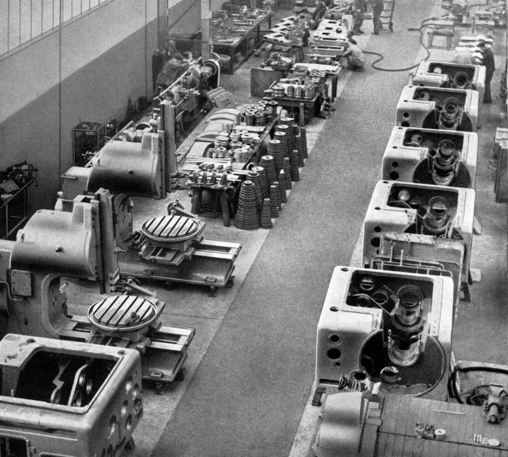

Left-hand lateral bay used for the assembly of sub units: to the right can be seen six headstocks intended for D-11-50S lathes and on the left two slotters (Type Stk-40 with a 400 mm stroke) and numbers of aprons, saddles, profiling tools posts, electric tracer units and piles of changewheels
