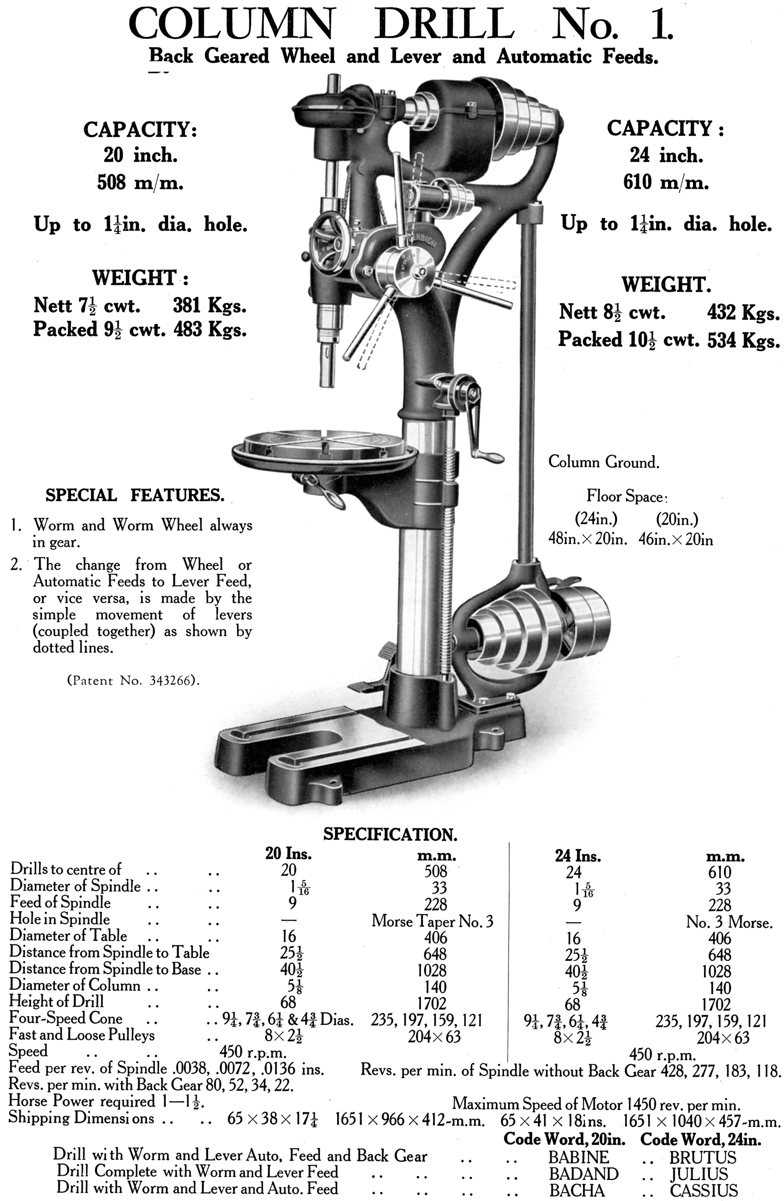

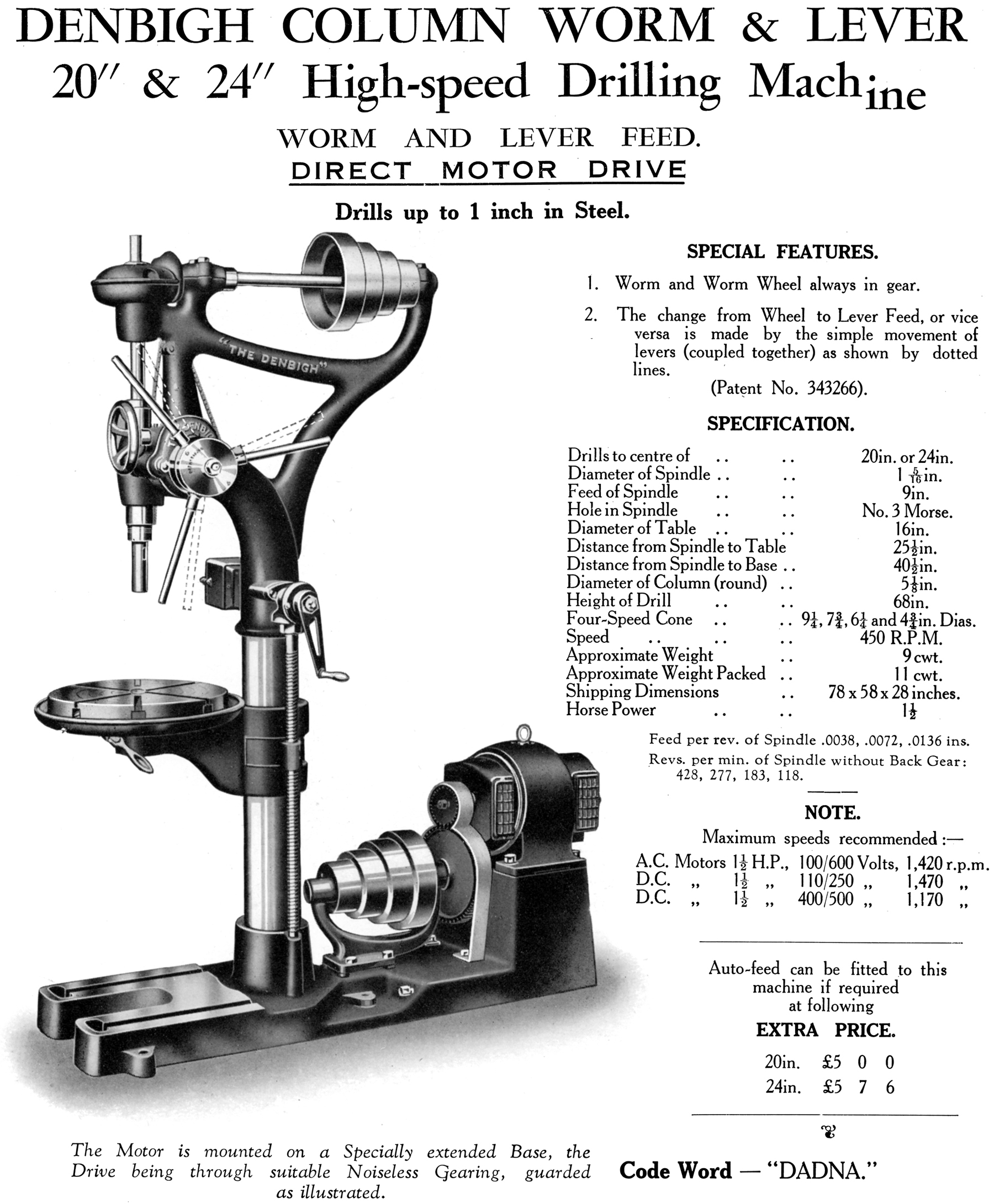

Denbigh drills were of an absolutely conventional design, their origins going back to Victorian times and little developed even after WW2 - though a few more modern bench and pillar drills with enclosed V-belt drive, the K and S Series, had been introduced during the 1950s.
Denbigh had their own foundry - unsurprising, as they were in the very heart of the original English iron founding area - and turned out castings to a very high standard. All their machine tools were heavily built, capable of absorbing continuous industrial use and were widely exported. Although their original design of "swan-neck" drill might appear hopelessly old-fashioned, they worked (and still do) extremely well with little to go wrong and having reserves of power. One model in particular, the
No.1, lasted almost until the company closed in the 1970s, a testament to its simple design and rugged construction.

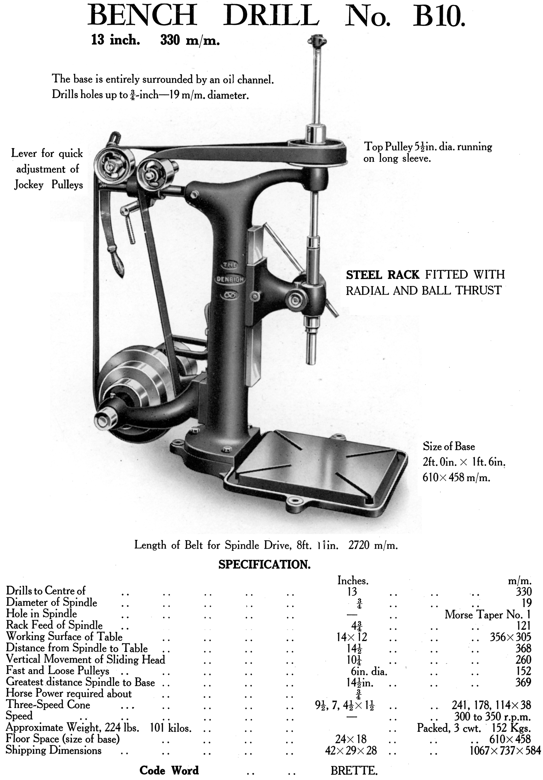

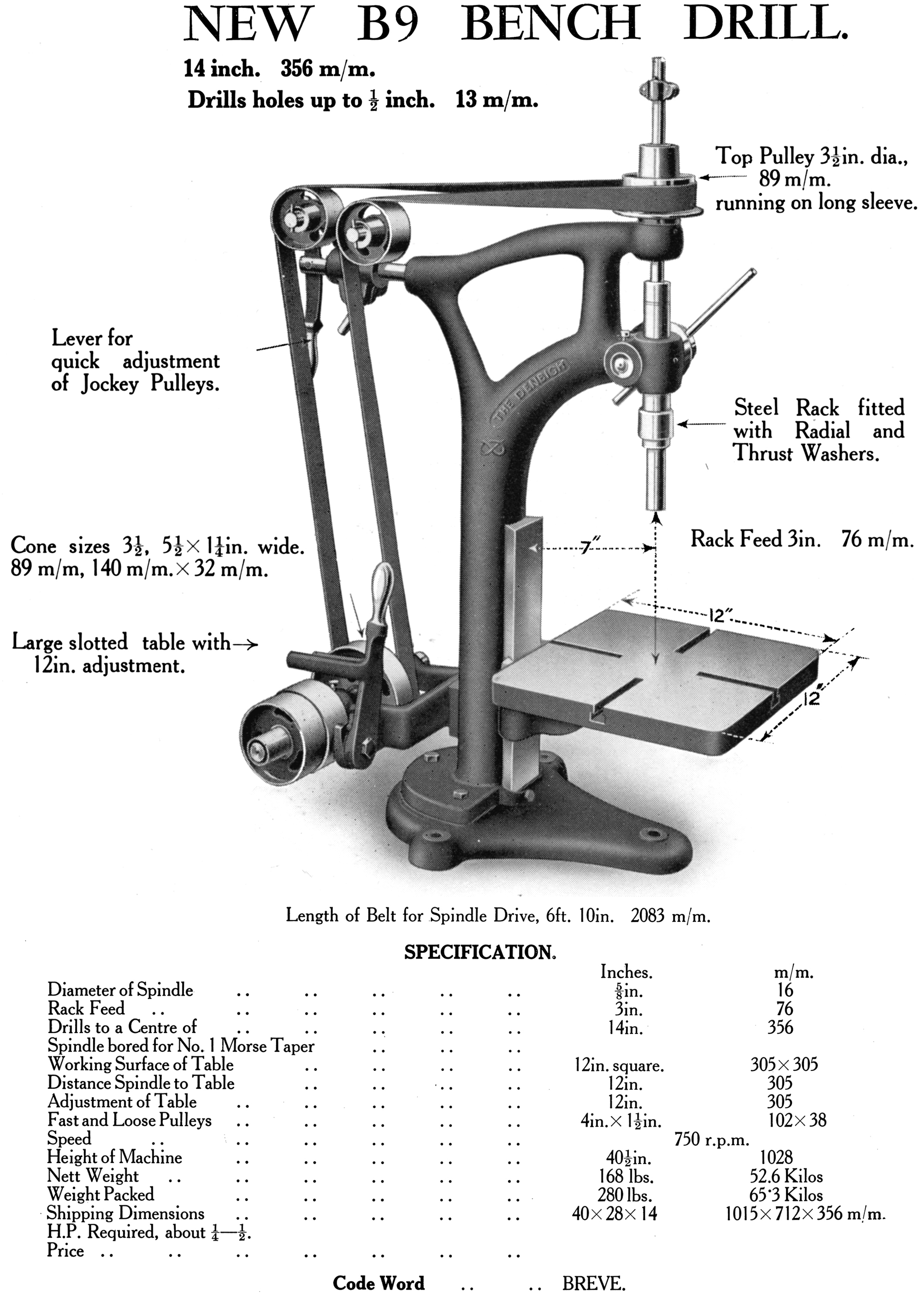

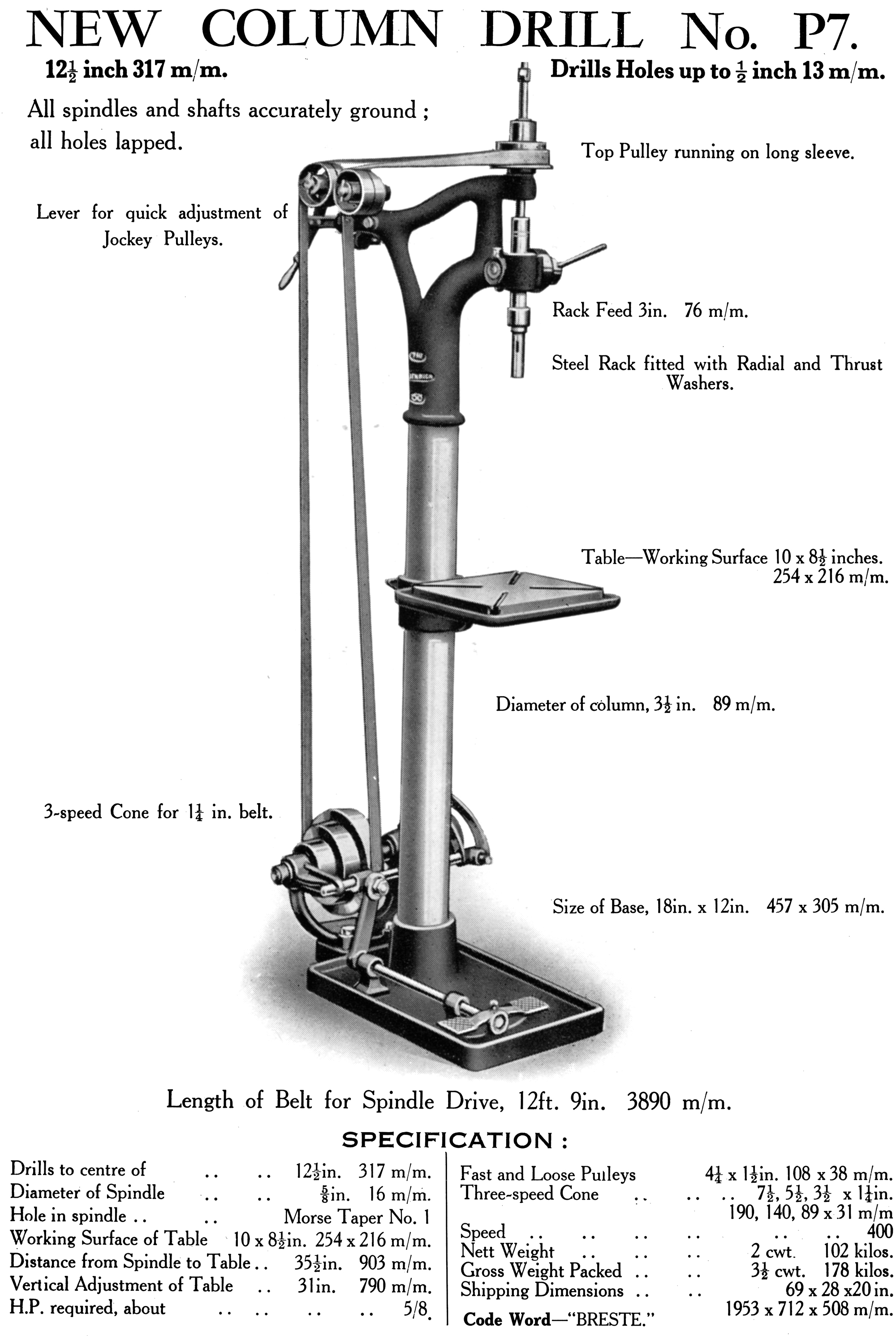

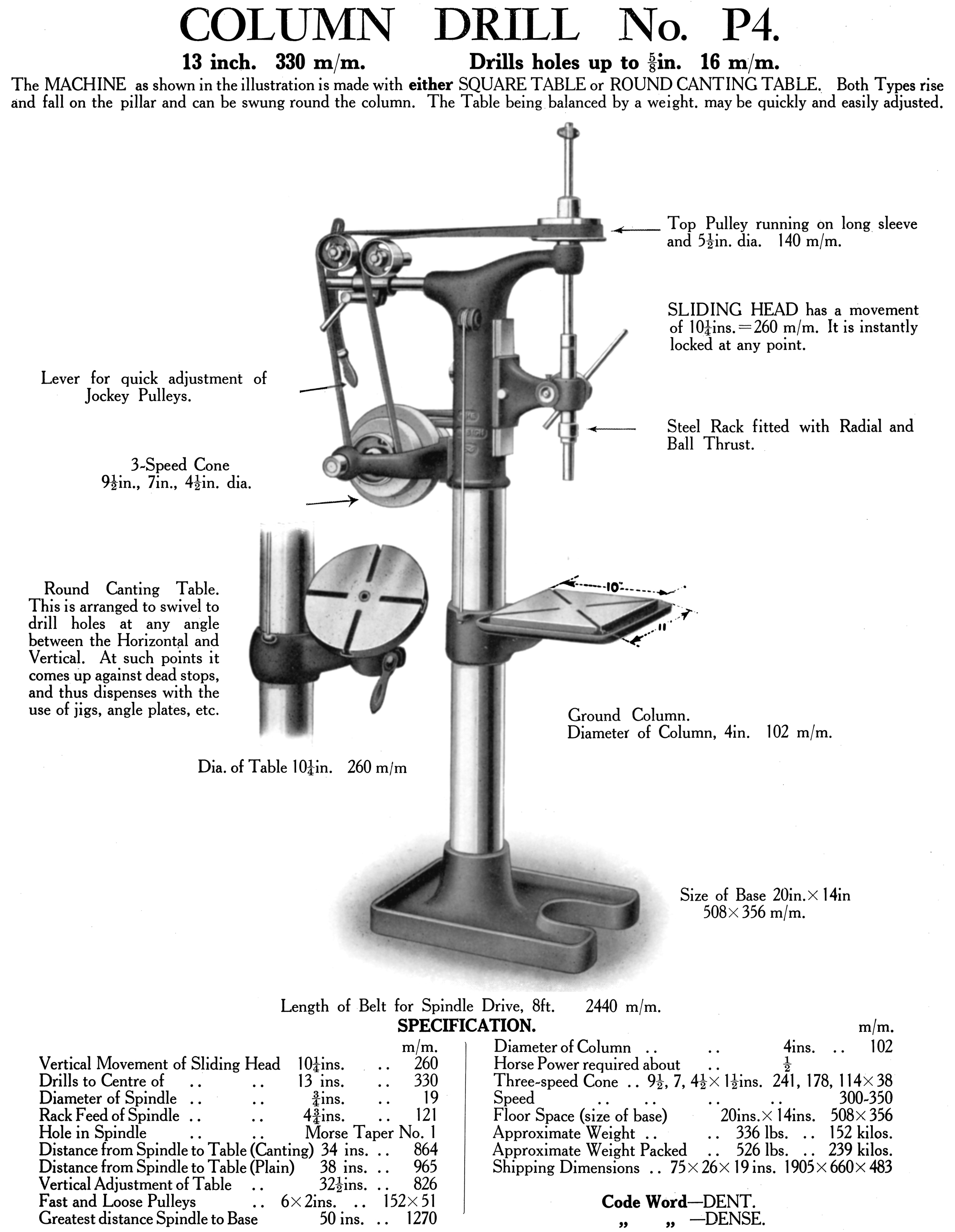

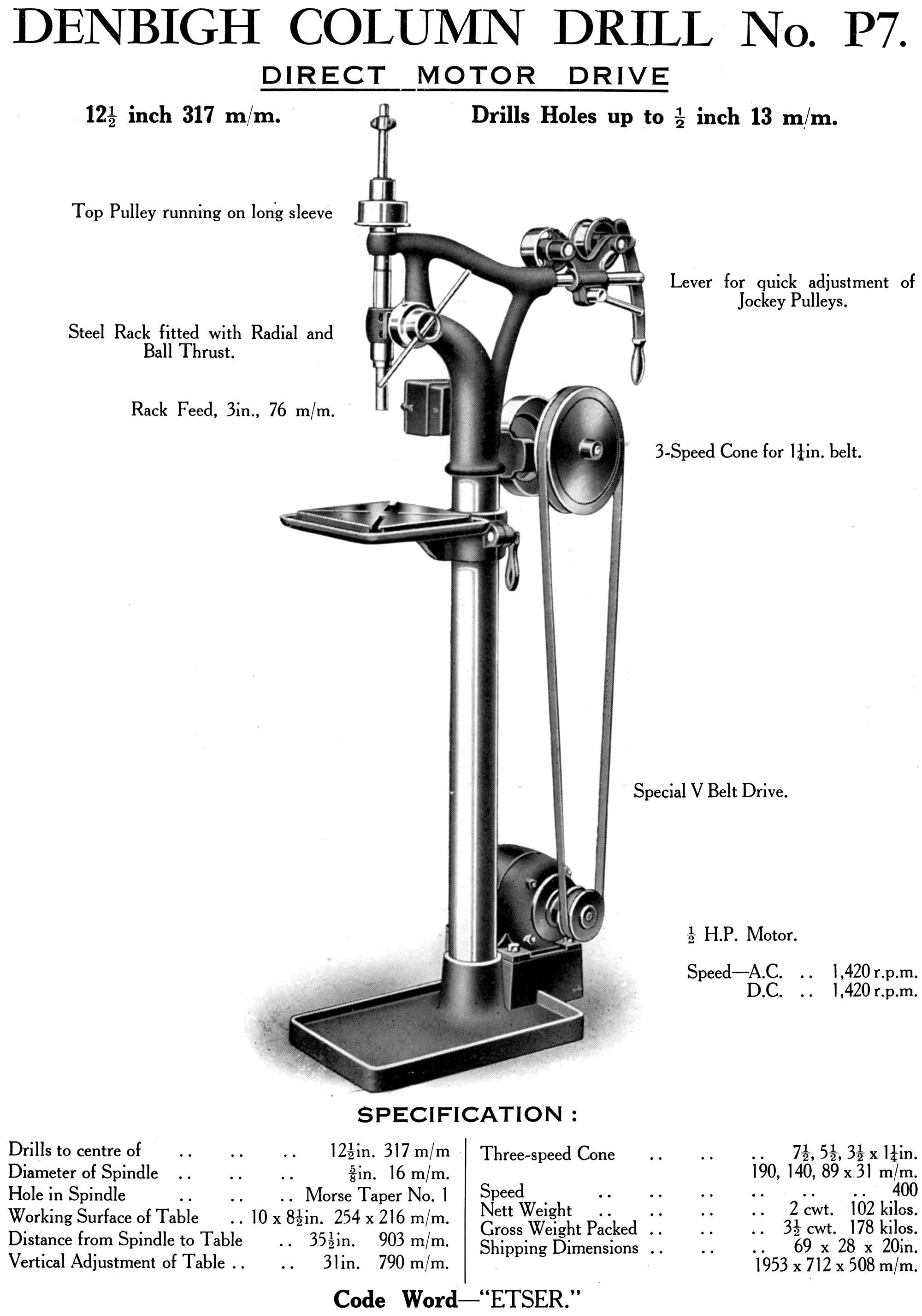

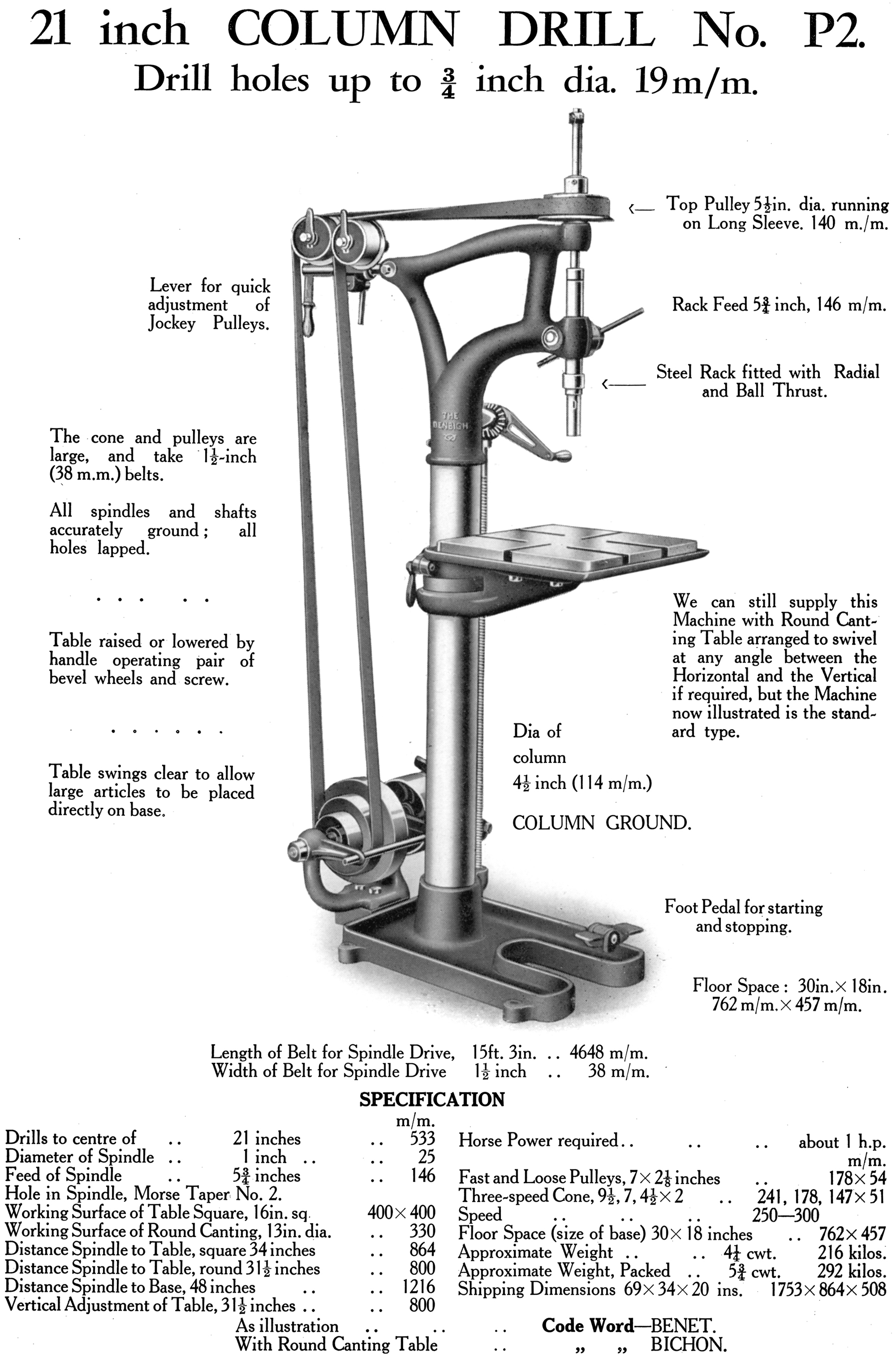

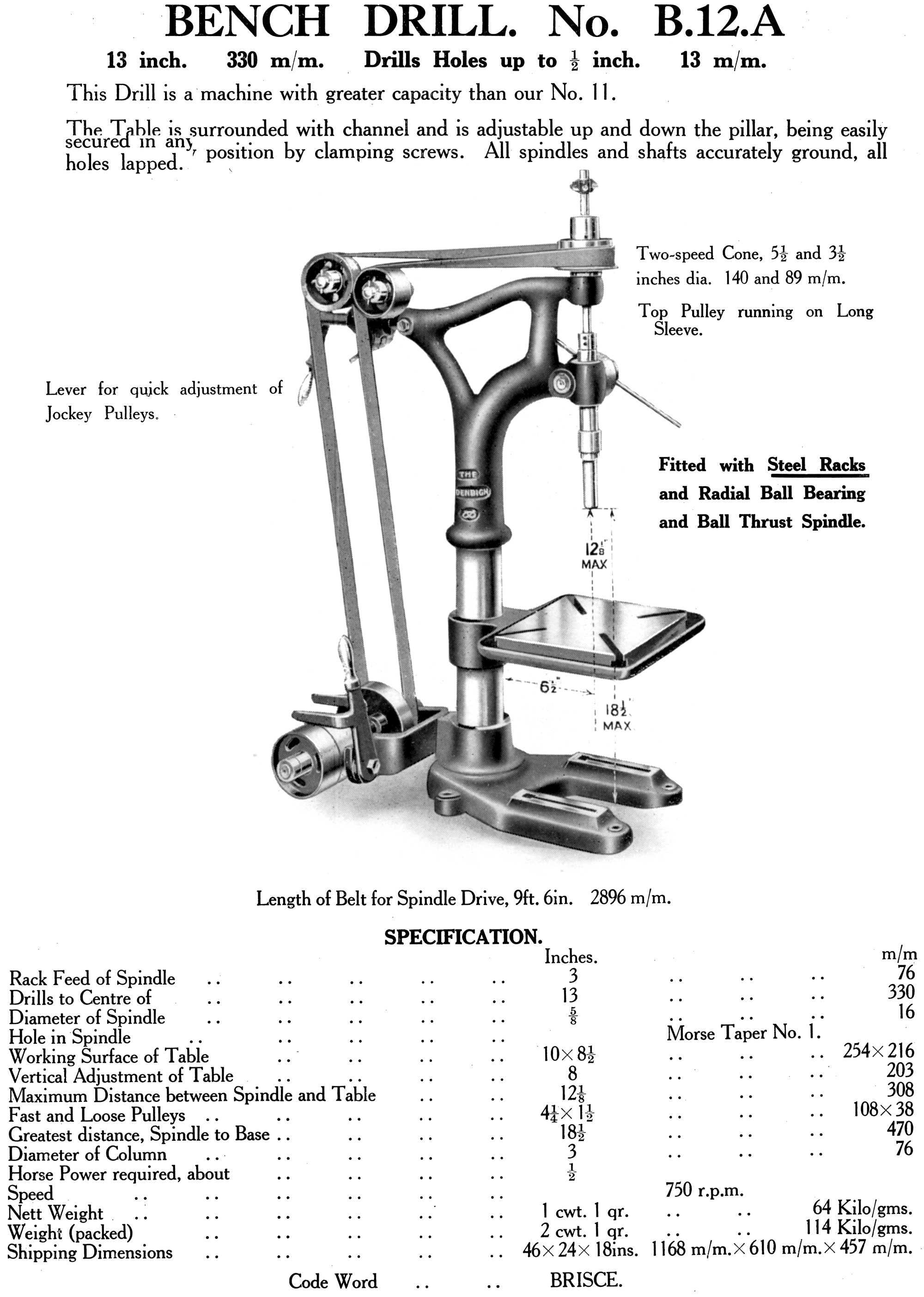

Shown below is a range of drills illustrated in a catalogue published circa 1930 and on this page from the 1950s and 1960s. The model designations and numbers chosen by the factory appear to have followed no logical sequence, drills of lesser capacity being mixed up with those of greater - and various suffixes and prefixes applied seemingly at random. No doubt it made perfect sense at the time - but not now.
