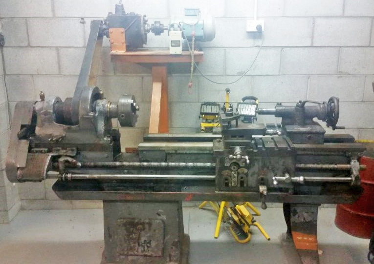

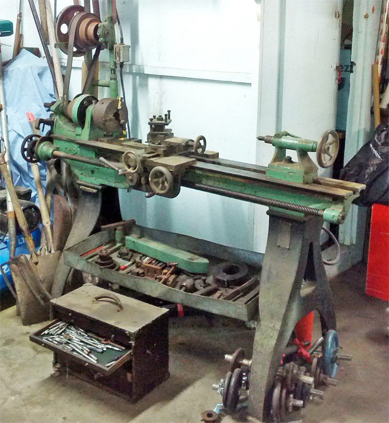

A Demster Moore & Co lathe from the late 1800s. Gap=bed, Backgeared and screwcutting
and probably with a centre height of 7 inches and a capacity between centres of 48 inches
Demster Moore & Co. Lt of Glasgow
