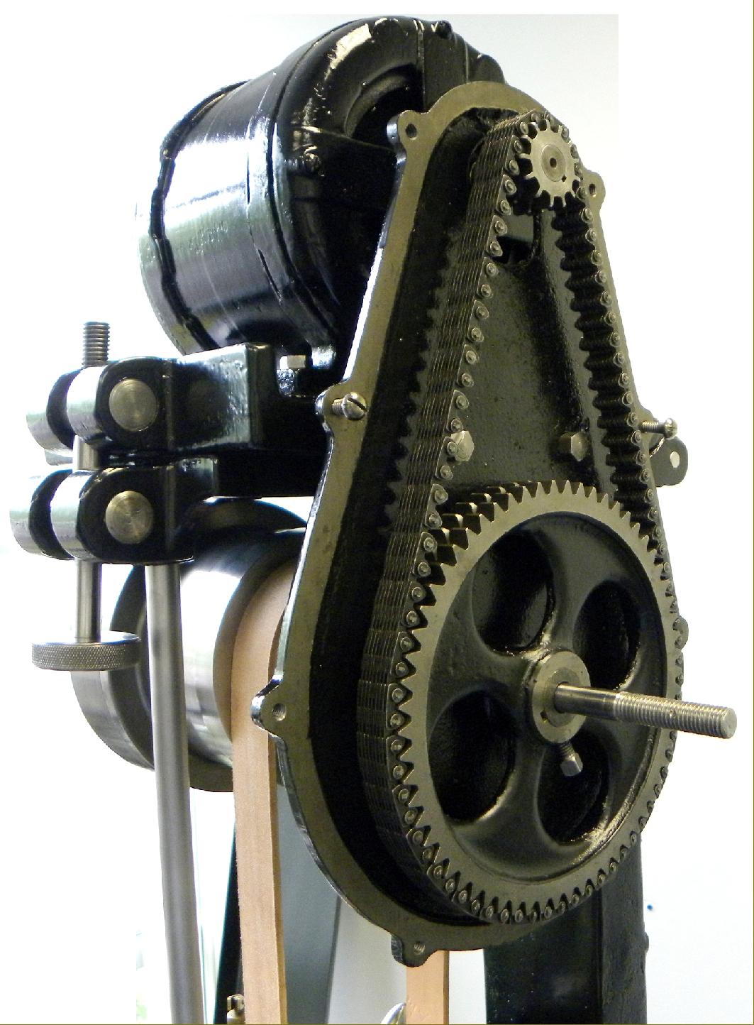

Of the planetary-reverse type, the massively built and very heavy overhead drive must have been one of the earliest types made by the Company, the design remaining something of a Dalton hallmark for several decades. The quiet-running sun gears in the drive were made from
Mycarda, or what is sometimes called canvas reinforced phonetic resin or linen board - many machines using used this and similar "developed" materials for gears, with even modern lathes such as the Emco 7, 8 and 10 Series, and several makes of geared-head drills and milling machines being so equipped.
