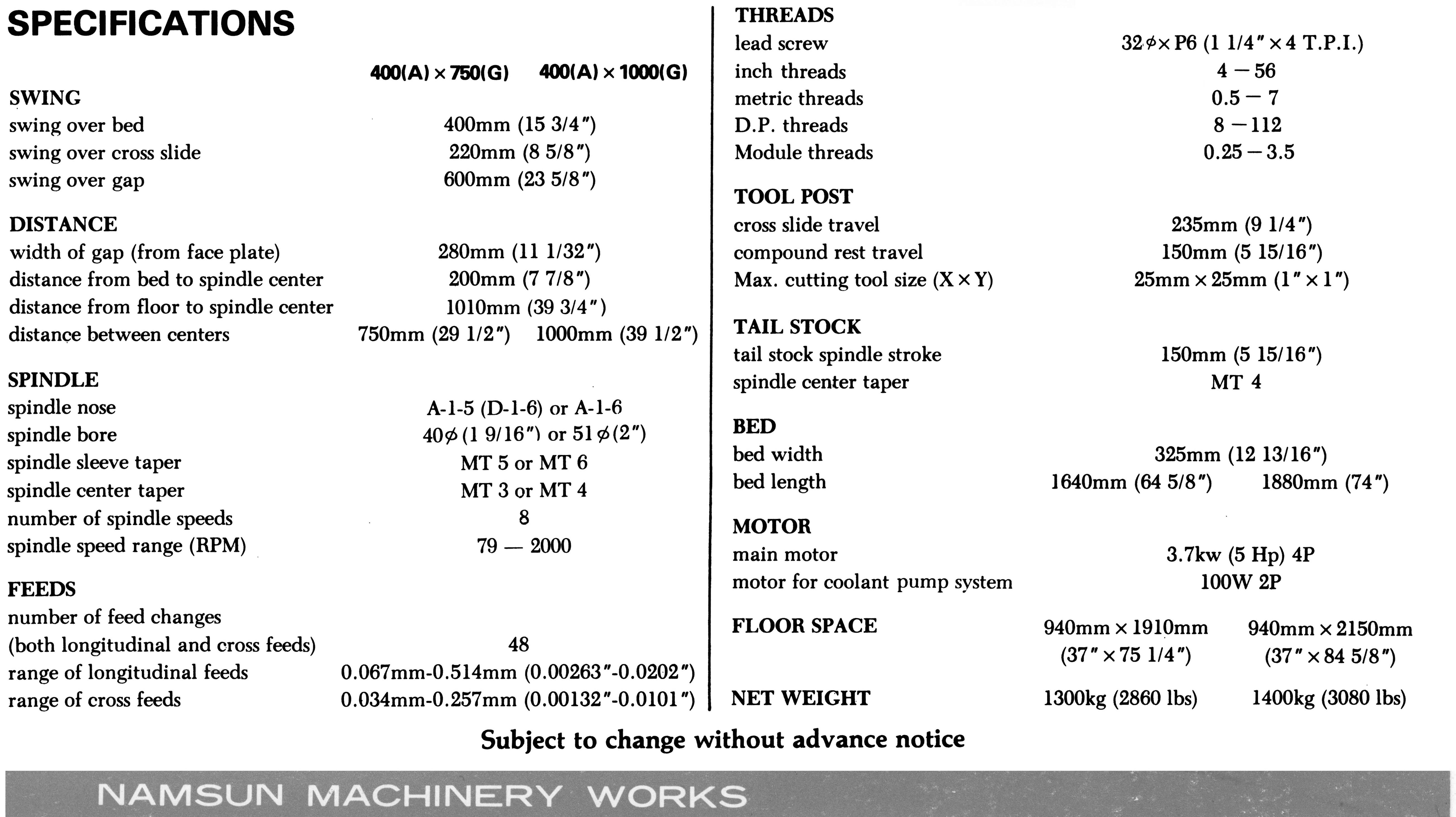

Three ranges of lathe were offered: the smallest model being the 200 mm centre height NSL-400 that could be had with either 750 or 1000 mm between centres. Mid-range machines were the 225 mm centre height NSL-450 with a choice of 1000, 1500 or 2000 mm between centres and the 275 mm centre height NSL-550, this range having one extra-long bed model available to take 3000 mm between centres. The largest Models were the Type NSL-700 with a centre height of 350 mm and between-centres capacities of 700, 1500, 2000, 2500 and 3000 mm. Full details can be found in the catalogue extracts below.
