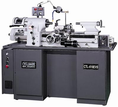

Producing a close copy of the well-known Hardinge HLV-H toolroom lathe, and based in Shen Kank, Taichung, Taiwan, the Cyclematic Company is under the control of Mr. Edward Chang who takes great pride in turning out a top-quality product. A full range of models is offered including one with a very clever digitally-controlled screwcutting arrangement that uses a servo-motor-driven leadscrew to replace the usual gearbox. Versions are also made fitted with CNC controls and for precision plain-turning, repetition capstan and second-operation work. It is thought that the Cyclematic is sold using different brand names around the world, e.g. in the UK it might be offered as the "Linear".
A recent examination of a machine by a user who demands the finest quality is revealing. He reports that the overall quality is far beyond that normally displayed by Chinese machines, with finish, fit and feel all being of an exemplary standard. As the lathe comes from Taiwan (and not the mainland) this is, perhaps, not surprising - the country has a long tradition of high-quality machine-tool manufacture. He reports:
"With the machine degreased, installed and levelled a 6 mm pin was inserted into a 6 mm (Taiwanese-made) collet and the run-out (with the spindle turning at a slow speed) tested. Using a top-quality, Mitutoyo 1µm indicator the needle did not move. Not even a quarter of one division. Run-out was, therefore, perhaps in the order of 0.0002 mm about half the wavelength of green light. Other collets provided a similar result, typically below 3µm. Only when a 25 mm rod turned down to fit into a 13 mm collet, did run-out drop to 0.01 mm. After a year's use, when the test was repeated, the results were unchanged.
Although the main spindle motor runs very quietly, the fans in the electrical cabinet make quite a noise, though this may be down (on this special-order example) to an extra fan installed to cool the power inverter that provides 220V (the normal being 440V). Unfortunately, the twin V-belts driving the headstock seem to fight each other, producing some vibration - though this IS belt maker's fault in not being able to provide exactly matched pairs, as was once common. The servo-motor that drives the leadscrew (this replaces the usual mechanical gearbox) is also extremely quiet, as is the power-feed motor.
The user was torn between ordering the traditional mechanical gearbox with a separate DRO, or electronic threading with an integral DRO - in other words, fancy convenience vs. reliability. Finally, the electronic version was chosen, its ability to show the actual feed rate being the deciding factor - with the ordinary system (as used on a Hardinge) the feed-rate per revolution can only be guessed at.  Oddly, Cyclematic retain the same upper limit for the pitch (4 t.p.i. or 6.35 mm) as the geared version, though there seems no reason why this could not be a little higher and would help with the manufacture of lens barrels with multi-start, 12 mm pitch threads (though in reality these are more easily done today on a CNC lathe)."

A CTL-618e with digital screwcutting and other lathes ready for dispatch from the Cyclematic works
         Precision plain-turning model                                                                                                                        Conventional model with screwcutting gearbox
