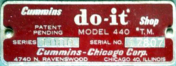

Cummins "do-it shop" Model 440 Woodworker

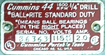

Also differing from the simple, single-function models from Black & Decker, Bosch and Bridges, the Cummins was advertised as 7 in 1 outfit, capable of being used as a lathe, saw bench, vertical drill press, disc sander, shaper and, by stretching the description a bit, a "horizontal drill" when set up as a lathe. The conversion to a drill press was especially well done, the supporting foot at the tailstock end of the bed forming a hinge around which the whole machine could be pivoted until vertical. The motor-carrying assembly was then unclamped and moved up and down by the built-in lever. In place of a separate table, the top of the saw bench was used instead, this, mounted on a swivel base, allowing it to be turned through the required 90 degrees. The makers also mentioned that the unit, could - quite obviously - be used as a hand drill, the particular model supplied being the 1800 r.p.m. Type 44 Ball-Rite with a capacity of 1/4". However, while the claim that this was: "

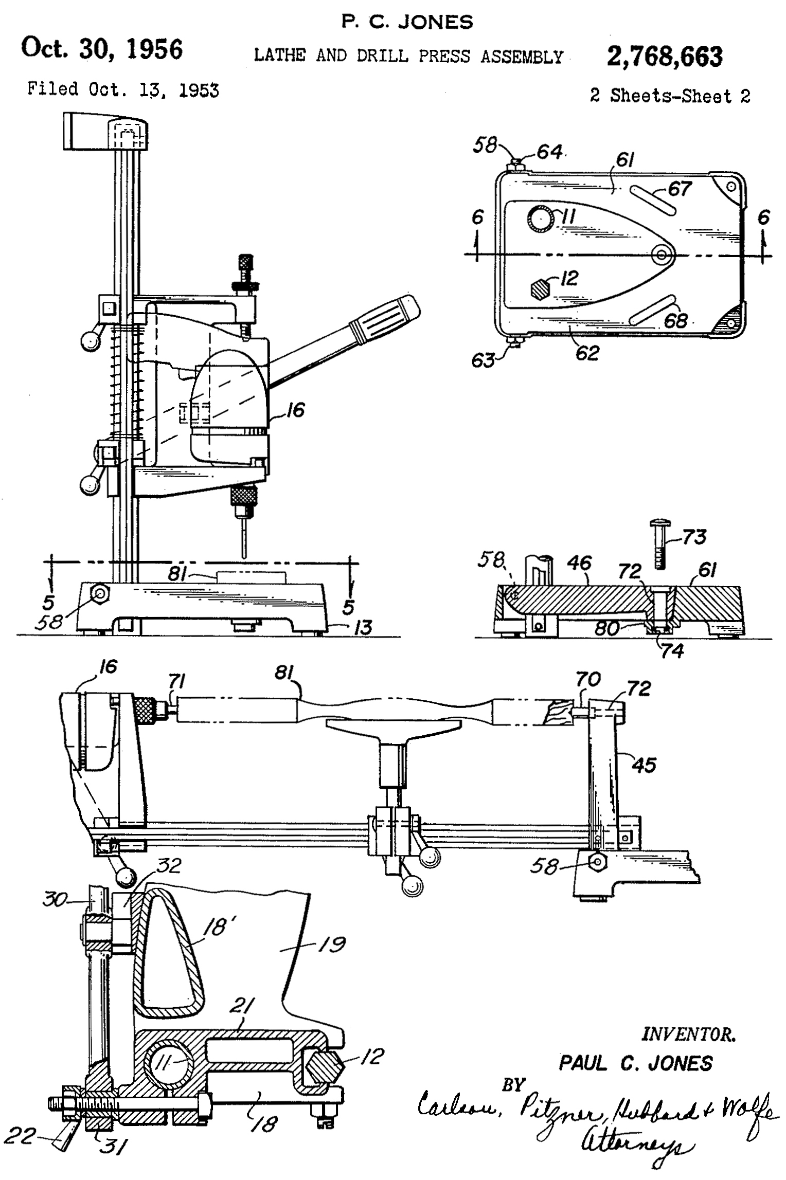

A whole furniture factory in 31/2 square feet"- might have taken liberties with the reasonable limits of advertising puff and that it could be set up on a kitchen table might have caused serious problems with the lady of the house -  the Cummins "do-it shop" would certainly have been a useful outfit for the impecunious and inexperience wood-working enthusiast. Designed by a Mr. Paul C. Jones, a patent was applied for the "do-it shop" on the 13th of October, 1953 and granted, with Number 2,768,663, three years later on October, 30th, 1956. Offered in 1953 at $79.95 complete and ready to run, by taking into account inflation, today's price (in 2018) would have risen by a factor of ten to $800 - not quite the bargain it appears to have been viewed from 64 years on.

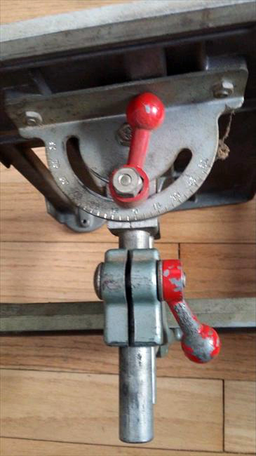

Saw table support

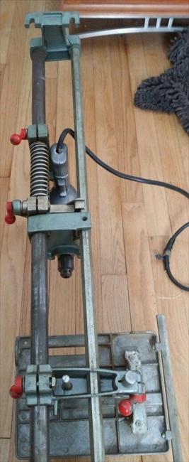

Underside of Model 440
