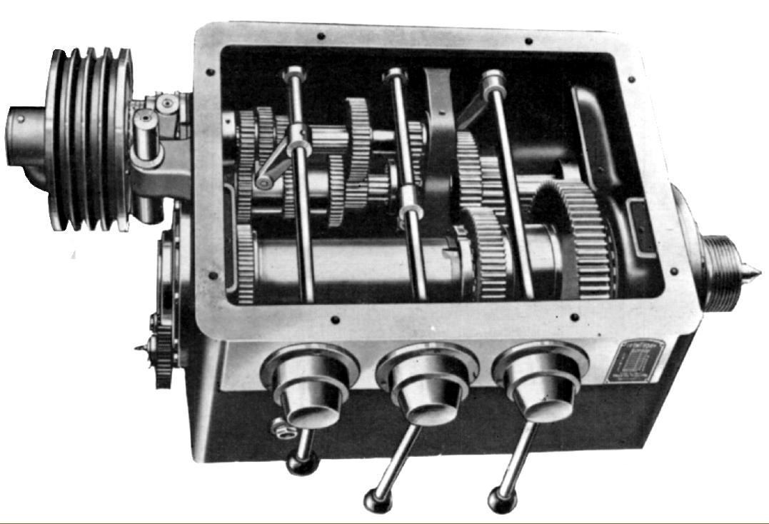

Complete headstock, drive system and screwcutting and feeds gearbox
Headstock - this example being fitted with a screwed spindle nose
