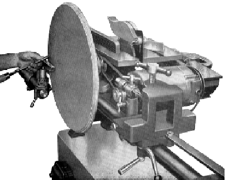

Band sander (CM508) and circular saw (CM502) fitted to an early 3-speed Major.

Circular saw, planer and tilting sanding table - all running from
one motor - a very compact and versatile combination.
