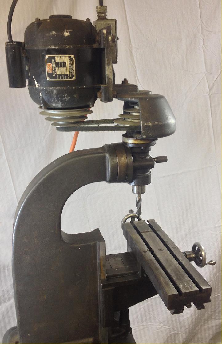

Columbia Millers were manufactured during the 1940s and 1950s by Columbia Enterprises, Inc., of Grays Lake, Illinois. A range of three vertical machines, the No. 1, No. 2 and No. 3, appeared to have been produced, all arranged along very similar lines. Simple in design and execution and of rather light appearance, the No. 1 miller had the upper part of its swivelling head formed into a strongly-built belt guard to which was bolted a motor platform - from where a standard, foot-mounted 1/3 hp 1750 rpm motor drove via a 4-step pulley to a hardened and ground spindle (probably fitted with either a No. 2 Morse or B & S Taper) running in Timken taper-roller bearings. The spindle speeds of 490, 978, 1750 and 3020 rpm were rather high, but suited the compact dimensions of the machine and the type of fine, complex work it was likely to undertake. However, at odds with this was the fact that, although the head could be inclined through 90 degrees each side of vertical, there were no quill feeds either coarse or fine, all depth settings having to be made by elevating the knee - an arrangement designed to cause the operator endless frustration as he struggled to reposition jobs that could otherwise have been done on one setting. Direct-fitting collets were of the Brown & Sharpe No. 00 dead-length type (with a maximum capacity of 0.5" ) tightened and released not by the usual draw-bar but a spring-loaded compression mechanism controlled by a handle engaging on a shaft that protruded from between the two swivel clamp screws in the middle of the lower section of the head. With two T-slots, the 4" x 15" table had a longitudinal travel of 9", laterally of 43/8" and vertical of 8". Oddly, if the maker's figures are to be believed, their No. 1 miller at 365 lbs and 68 inches in height, was a more massive and taller machine than their No. 2. If you have a Columbia milling machine or any literature about them, the writer would be interested to hear from you.
The upper part of the vertical head was formed into a strongly-built belt guard to which was bolted a motor platform from where a standard foot-mounted 1/3 hp 1750 rpm motor drove via a 4-step pulley to a hardened and ground spindle running in Timken taper-roller bearings fitted with a No. 2 Morse Taper. The long boss protruding from the middle part of the head was the point where a handle fitted to operate the quick-release collet mechanism.
