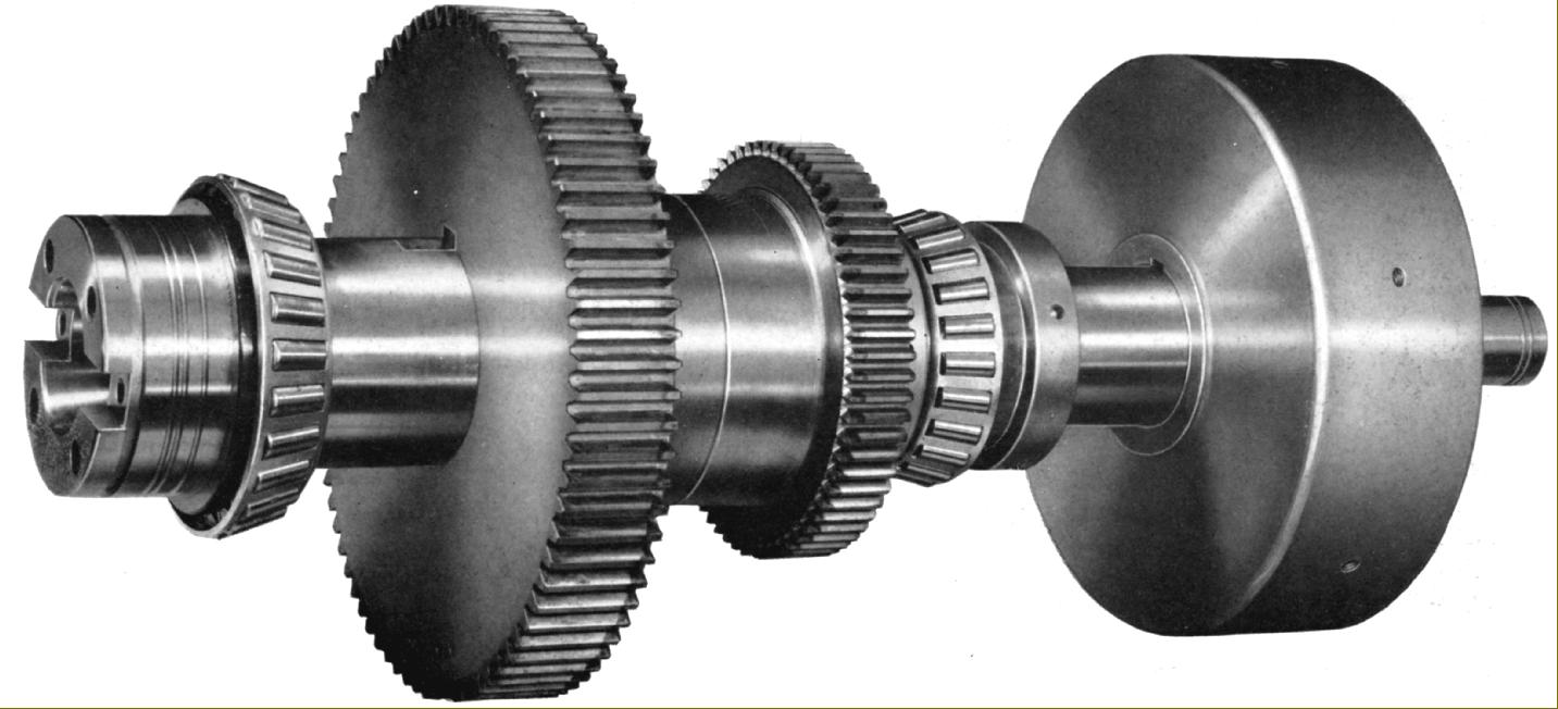

Continued: Drive, Spindle and Overarm Mounted in the base of the column on a simple, vertically adjustable platform, the motor drove up to the spindle gearbox by V-belts. The two smaller machines both had 10 h.p. motors, the Model 315-16 a 15 h.p. and the 420-16 a 20 h.p. All versions (including the vertical) had 24 speeds with 18 to 1800 r.p.m. used on the two smaller versions and 16 to 1600 r.p.m. on the larger. Hardened and ground, in forged nickel-chrome steel, the main spindle ran in two high precision taper-roller bearings and one ball-type anti-friction bearing. On horizontal models the spindle diameter at the front bearing was 4 inches on 200 series machines and 4.375 inches on the 300 and 400. On vertical machines the same diameters were 3.75 inches on the 200 and 4.5 inches on the 300 and 400. To assist with high-speed milling when using carbide tools the spindle was equipped with a heavy flywheel assembly mounted on its outer end. All versions of the Cinedo were fitted with an "Arbor-loc" spindle nose, a Cincinnati design introduced as an optional-extra during the 1940s that had become a standard fitting on many of the company's general-purpose machines. Whilst provided outstanding rigidity, the assembly allowed an operator to change direct-fitting cutters, collets, adaptors and even long arbors in just a few seconds. Even if, for production purposes, using heavy-duty arbors and ganged cutters, a drawbar had to be used, this did not interfere with its simple operation. The unit worked by incorporating, on the spindle nose, a pair of adaptor half-nuts (held in place by spring clips) to accept a screw-on adaptor ring. A constant problem with any machine-tool used to the limits of its capacity and strength is vibration; and to help overcome some if its effects Cincinnati replaced the ordinary hollow-cast overarm with what they called a "Dynapoise" unit. This incorporated a mass-balance weight that was set at the factory during pre-delivery, final run-off testing, to give the smoothest possible cut at high rates of metal removal. On vertical models the totally enclosed, oil-flooded head had power feed fitted as standard, with a useful automatic release through a four-position turret stop with extra-long screws. If the feed was set to trip-out just before the required dimension, the final cut could be done by hand working to the built-in dial-test indicator. Once selected, the head feeds were controlled by the same crank handle on the front of the knee used for the control of the table feed rates. Sixteen rates were usually specified (though, as with table feeds, thirty-two could be ordered if required) that ranged from 1/4 to 30 (or 3/16 to 24) inches per minute and with a rapid-traverse rate of 70 inches per minute. Like the column and knee ways, those on the head were square, with rectangular gip strips to finely adjust each sliding surface Lubrication Unlike many previous Cincinnati millers that used a combination of automatic and manual lubrication (with oil fed to the knee and table ways by a hand-operated pump) on the Cinedo the entire system was automatic. A main reservoir was positioned inside the knee where, as soon as the main motor started, a mechanical pump both sprayed oil over the various mechanism inside and provided a supply under pressure to the table, column and saddle ways and to the moving parts of the feed mechanism. Continuing Cincinnati practice since the early 1940s, the heavily stressed knee elevation mechanism - it consisted of a one-piece, nitrided-steel screw, supported on taper roller bearings and running through an aluminium-bronze nut - was completely enclosed in a bath of EP oil. A separate header-tank positioned to one side (and level with the screw's top) fed oil down a pipe to fill the housing as the screw rose and fell. There was no lubrication responsibility on the part of the operator, other than to check the level of the main oil reservoir occasionally and apply an oil-can to a few of the hand controls. Accessories Both a number of useful accessories and adaptations to the specification were offered for the Cinedo, although nearly not as many as would have been available for a similar machine before the 1960s - the increasingly specialised nature of machining making the universally-adaptable miller increasingly irrelevant for production work. One especially useful addition for the Plain and Universal models was the "Independent Overhead Spindle" - a Ram-type" enclosed-motor, all-geared vertical head that could be left in place and used to support the standard drop-bracket used for horizontal milling. The unit was available in two forms, with 3 or 5 h.p. motors, each offered with a choice of four speed ranges, fixed at the time of ordering: 50-750; 75-1125; 100-1500 and 150 to 2250 r.p.m. Both fixed and sliding quill versions were listed, with former being double-jointed and able to be swivelled 360° both parallel and square to the axis of the table. Electrical control was through a swinging pendant. Automatic Table Cycle Offered on Cincinnati plain horizontal and vertical millers from the late 1950s onwards, the automatic table cycle control system was intended for production work. It enabled an operator to set up, using specially-shaped trip dogs in a just single T-slot on the table's front face, a sequence of simple but fully or semi-automatic operations that included all aspects of table control including movement direction, feeds and rapid traverses. Three additional controls could be added to the table cycle system, all built into the machine when new: Automatic Spindle Stop, Live Rapid Traverse and Automatic Knee Retraction. Whilst the Automatic Spindle Stop was just a simple (factory-installed) option to extend the usefulness of the automatic table cycle, Live Rapid Traverse was a more complex mechanism that provided an over-riding action built into the rapid-traverse mechanism. This, once selected, allowed the operator to set the position of the rapid feed trip dogs quickly and accurately by first mounting them in approximately the right place, starting an automatic cycle and then, when the cutting cycle engaged, using the rapid traverse lever to jog the workpiece close to the cutter. At this point the sequence was stopped, the dog set snugly against the cycle control lever and locked in place. The Automatic Knee Retraction system ensured complete safety during auto-cycle work by retracting the knee by 5/8" as the 'rapids' operated and returning it to the previous position immediately afterwards..

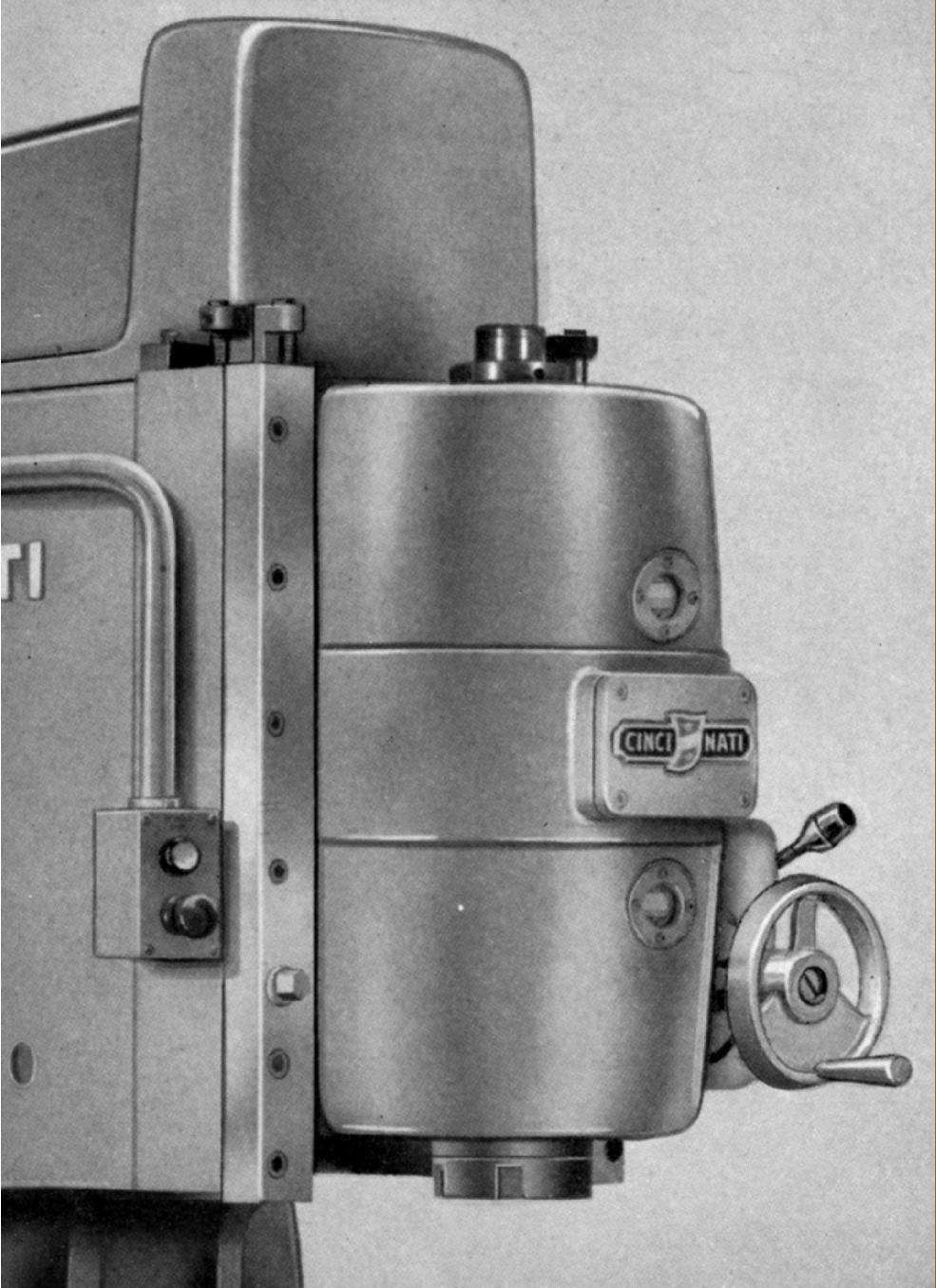

The vertical head was fitted with lever-controlled power-feed and rapids as standard and a four-position, automatically disengaging turret stop with extra-long screws. If the power down-feed was set to release just before the required dimension, the final cut could be done by hand using the built-in dial-test indicator.
Vertical head showing the twin oil-level windows

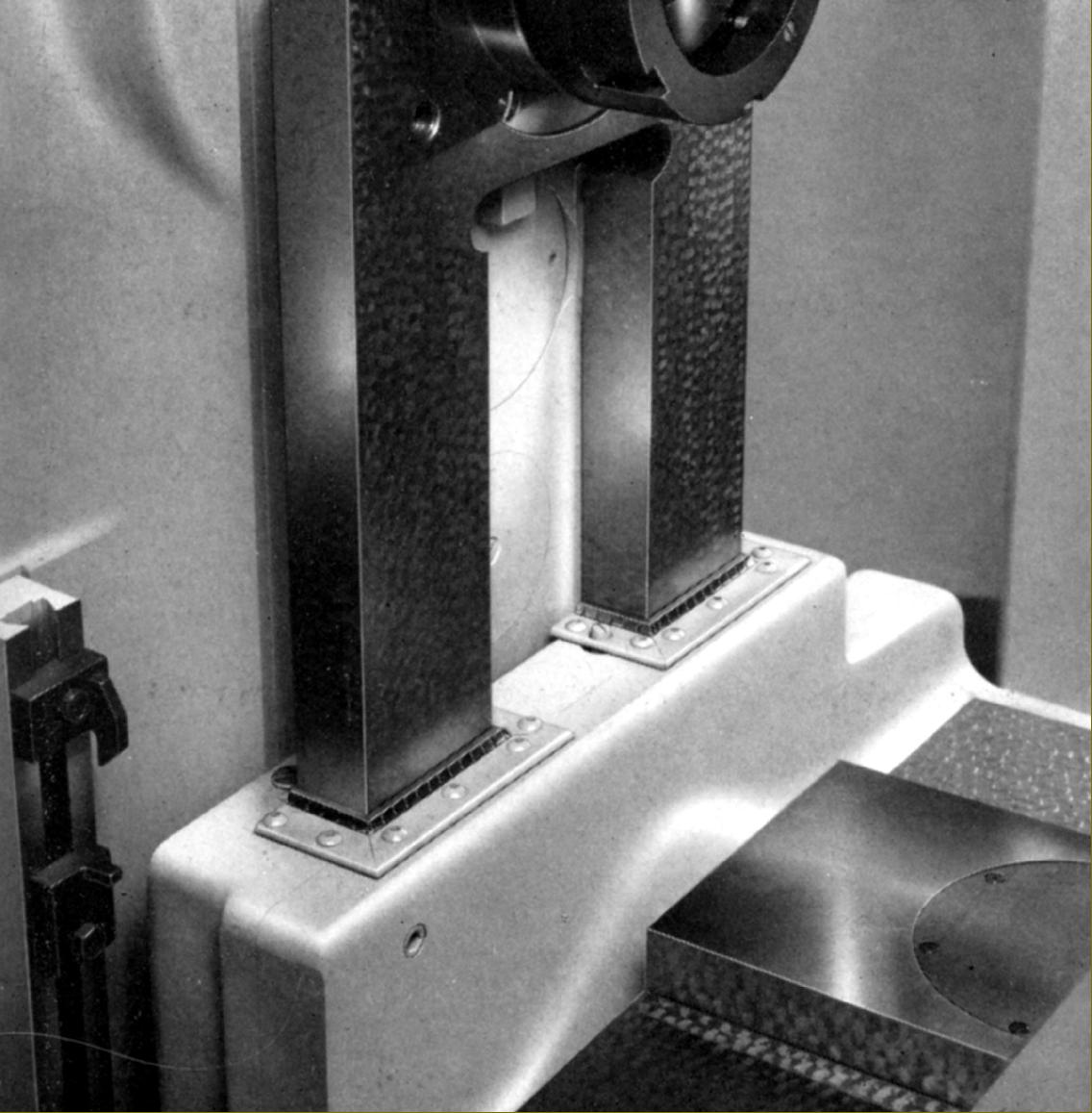

Like all Cincinnati general-purpose millers the Cinedo had a particularly massive and rugged knee. Instead of the common V-ways on the column-to-knee and knee-to-saddle mountings used by many other manufacturers, Cincinnati employed square ways fitted with a total of three gib strips that allowed a very precise adjustment of each sliding surface.
Tight-fitting way wipers on the knee-to-column ways
Hardened and ground in forged nickel-chrome steel the main spindle ran in two precision class taper-roller bearings and one ball-type anti-friction bearing. On horizontal models the spindle diameter at the front bearing was 4 inches on 200 series machines and 4.375 inches on the 300 and 400. On vertical machines the same diameters were 3.75 inches on the 200 and 4.5 inches on the 300 and 400
