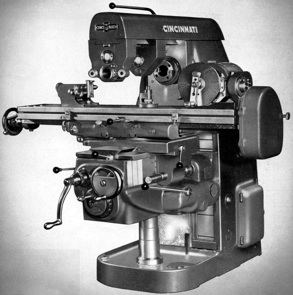

Introduced in the U.S.A and Great Britain during 1946 (at £1045 in the latter, then around twice the price of a good semi-detached house), and manufactured until the 1970s (as the 203, 205, 307 and 410 and variants), the No. 2 M1 was the Company's entry-level, general-purpose knee-type model. Fitting in below the established, much larger and more expensive "Dial Type" machines, it was built in one size only (as the No. 2) and had smooth, rounded and contemporary lines that reflected the era's fascination with "streamlined" styling. It was available in three forms: as a Plain Horizontal, a Universal (with a table able to be swung 45°either side of central and fitted with a powered dividing head), and, from the late 1940s, as a Vertical. In addition, each of the two horizontal types could be converted into very useful ram-type vertical machines by the addition of a self-contained overarm with a motorised gearbox and swivelling end section. The later machines, as made from the the early 1960s were given new Model types, MI and ML, and suffix numbers: 203, 205, 307 and 410m -designations from which the basic specification of a machine could be deduced.  The first digit "2", "3" or "4" indicated a table travel that was, respectively, 28, 34 and 42 inches. The next two digits "03", "05" etc. was the motor horsepower (3 h.p. 5 h.p. ) with the final two digits giving the table width in inches. e.g. the 205-12 MI had a 28-inch travel table, a 5 h.p. motor and a table 12 inches wide.
Table & Feeds
Reflecting the latest thinking and careful design, the miller's neat appearance was partially the result of ensuring that the saddle, knee and coolant pump drive shafts were fully enclosed (with the cross-feed screw protected by sliding covers against the ingress of swarf and dirt) and the knee sealed, with non of its mechanisms exposed. Early examples of the M1 had a table with a working area of 49" x 10" (with an over-all size of 52.75" x 10") with three 11/16" T-slots spaced 2.3125" apart. The longitudinal travel was 28", in traverse 10" and vertically 19" - although on the Universal, with the increase in saddle thickness to accommodate the swivel mechanism, the last figure was reduced to 18". From the spindle centre line to the table surface was a maximum of 19" on the plain horizontal model and 18" on the Universal - with a minimum of 0". Driven from the main motor, table feeds on both horizontal travels had a usefully wide range of settings with rates from ¼" to 30" per minute and from 1/8" to 15" vertically (a set that spanned a ratio of 120 : 1). As a no-cost option the miller could, when ordered, be fitted with quicker feeds from ½" to 60" per minute. Able to be operated with or without the spindle running (and so ideal for assisting with the set-up of long jobs), rapids were fitted to all feeds - both horizontal being at 150" per minute and vertically half as fast (with the rate remaining the same when the faster feed set had been specified). Changes of rate were by a crank, positioned conveniently on the front of the knee (an arrangement introduced on later Dial Type models) where a half-turn of the pull-out handle selected the next higher or lower rate - a large, clearly-marked dial showing the chosen setting. Conveniently positioned short levers - that for longitudinal being set centrally on top of the saddle, for traverse on top of the knee and for vertical to the front of the knee's left-hand face - controlled the feed engagement. Each control had a positive neutral, forward and reverse position - not always the case on competitors' machines. When the power feeds or rapids were engaged the heavy, flywheel-effect handwheels - which include an open segment, opposite the handle (to allow the operator's fingers to grip the rim for a better feel on fine feeds) - were, for safety, automatically disengaged. Relatively small but beautifully engraved, the micrometer dials used a pull-and-turn mechanism (against light spring pressure), to zero them - an arrangement that eliminated possible setting errors as a locking knob or ring was loosened or tightened. In addition to the expected adjustable table stops on each axis, the 2MI was fitted with positive limit stops for each travel, thus ensuring that a machinist could not overrun the limits of the table or knee travels and wreck the mechanism. While the knee and saddle locking clamps were lever operated (the levers turning screws) that for the table required the services of a loose spanner; should an operator have forgotten to slacken the locks upon engaging a feed, damage was prevented by a safety clutch.

The Cincinnati No. 2 MI as advertised during 1946

Spindle, Drive and Arbor Arrangements
Fitted with a No. 50 INT nose and carrying a large drive gear designed to add inertia, the spindle was manufactured from a nickel-steel forging, ground all over and ran in Timken taper roller bearings at the front and centre with a precision roller race at the rear. Driven by a 1450 r.p.m., cradle-mounted, 5 h.p. motor through four V-belts, a single-plate dry clutch and a gearbox, it had 16 speeds of: 25, 33, 43, 56, 76, 100, 130, 168, 225, 295, 385, 500, 680, 895, 1160 and 1500 r.p.m. Alternatively, low or high-speed ranges were available - the former spanning 20 to 1200 and the latter 33 to 2000 r.p.m. Like the table feeds, spindle rates were changed by a trade-mark Cincinnati speed dial with crank; positioned on the left-hand face of the column it was possible for the operator to lean over the table and reach the handle - one half-turn of which selected the next higher or lower setting - a separate quadrant lever immediately beneath being used to select forward, neutral or reverse. All gear shifting (spindle speeds and table feeds) were, even on this less-expensive model, by hydraulics. To start and stop the machine an adjustable lever was provided that could positioned where required - the operator simply having to lift it up to disengage the gear teeth on its end, swing it round and drop it back into place. As a safety precaution, when the spindle was running the speed selector was locked (more expensive Cincinnati millers could change speeds while running, their gearboxes being fitted with synchromesh cones). The arbor was supported by a rectangular-section overarm constructed so as to provide a degree of damping using what Cincinnati called their "Dynapoise" system. The arm was repositioned by a 2-spoke capstan handwheel, through the hub of which passed one of the two securing bolts - each passing right through the casting to give the best possible lock against its dovetail ways. Two arbor supports (drop brackets) were supplied with each machine: both were made of aluminium and complete with an oil reservoir large enough to last for several days' use. Type A was intended for arbors with a plain end while the other, Type B, was for those fitted with bearing collars. The Type B also had provision to clamp on an overarm-to-knee bracing bar that was reversible and hence able to be fitted to either the left or right hand side; at extra cost the type could be supplied without the mounting point.
