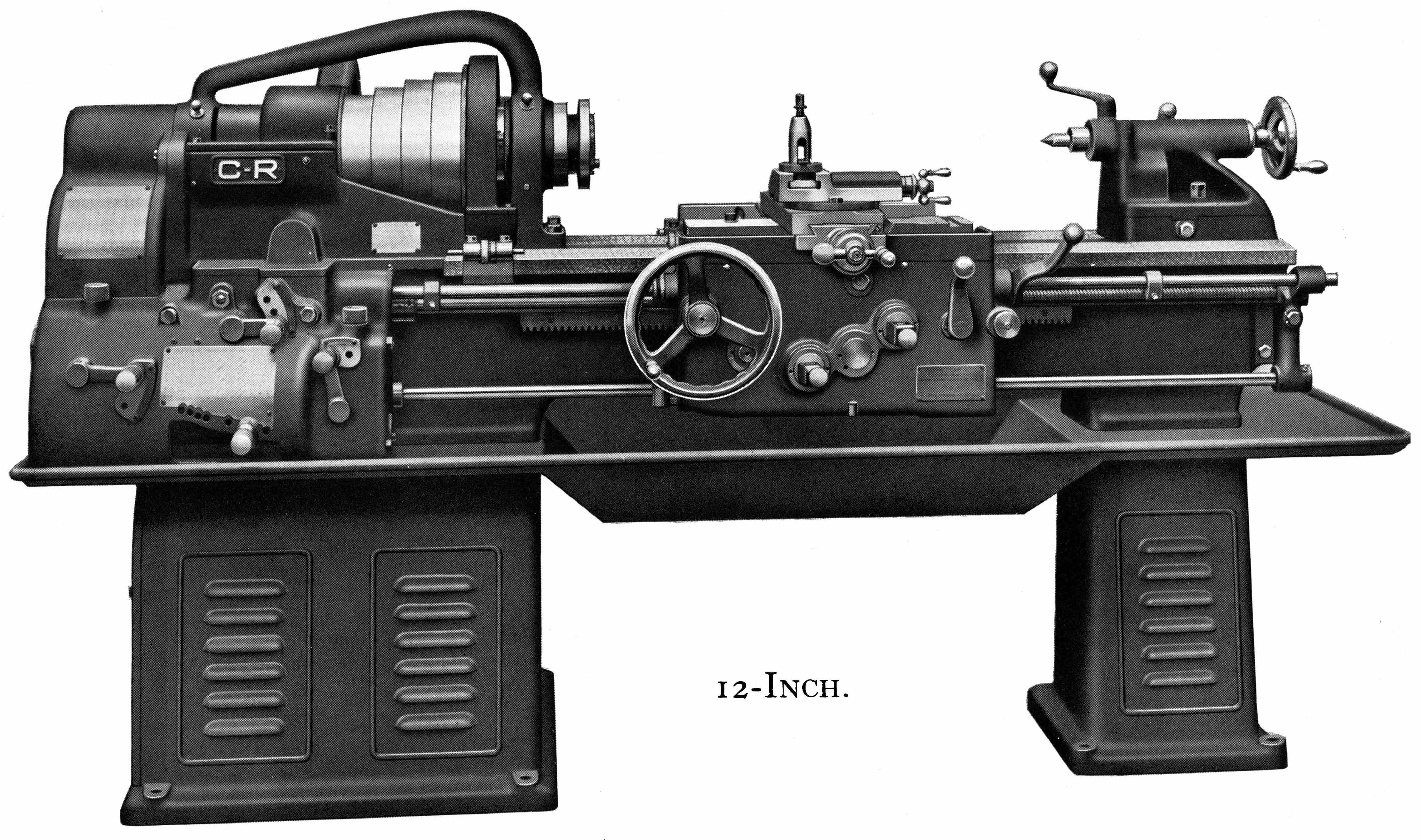

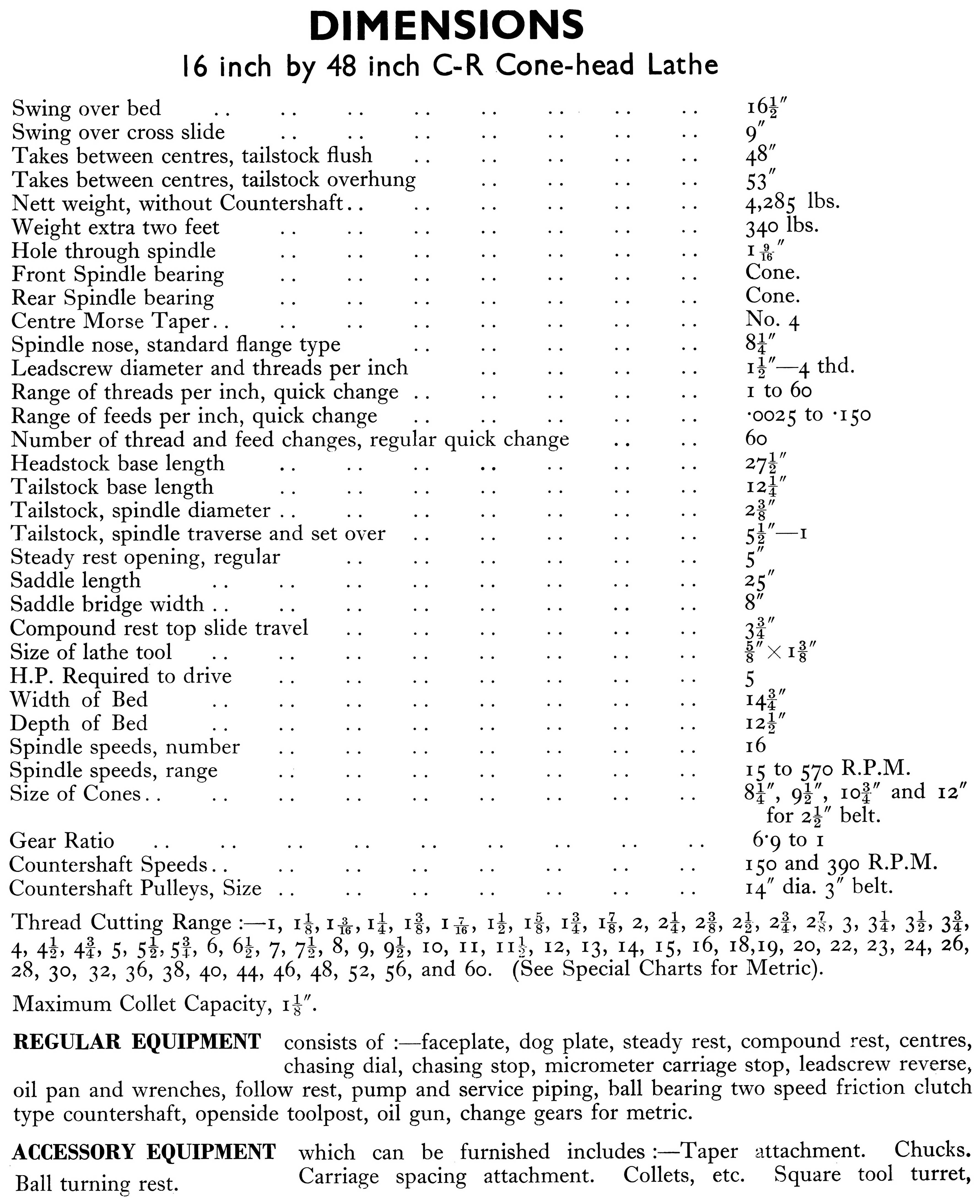

A Churchill Type "C-R" cone-drive lathe from the 1930s. This model could be had with centre heights of 6 and 8 inches (listed by the makers with the swings of 12-inch and 16-inches)
