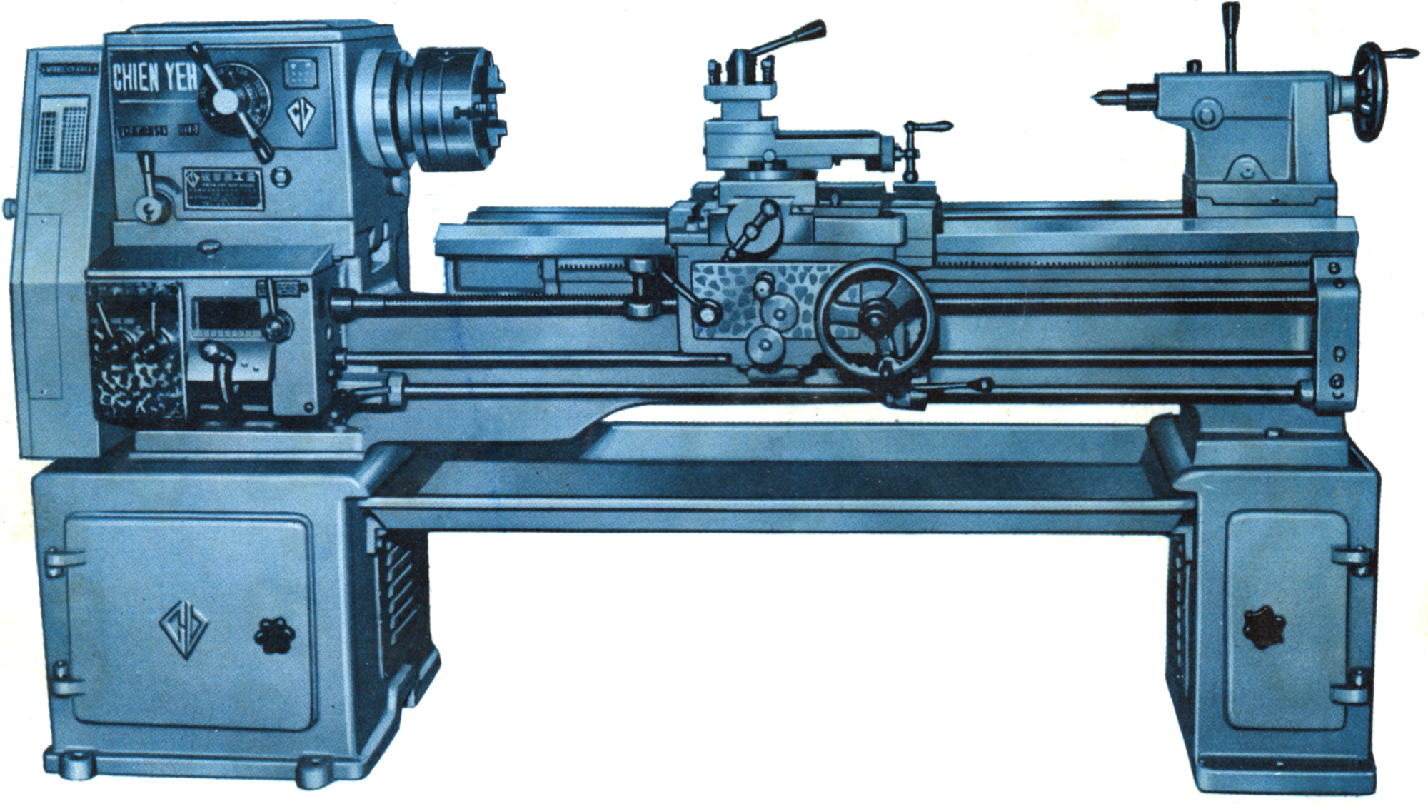

Geared-head 7-inch centre height CY-600AS and CY-500AS that differed only as to their capacity between centres - respectively 42 and 30 inches. They were fitted with their own design of single-tumbler, twin-lever screwcutting and feeds' gearbox but fitted with the same design of carriage as the FGK Series models.
Geared-head, 7-inch centre height CY-600AS and CY-500AS
