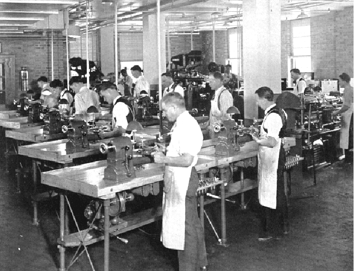

IBM Workshops, Endicott, New York, in the early 1930s Ten Hardinge cataract underdrive bench lathes being used by uncomfortably well-dressed gentlemen who, though retaining their ties and waistcoats for the day's labours have, at least, taken off their jackets, rolled up their sleeves - and donned white aprons.

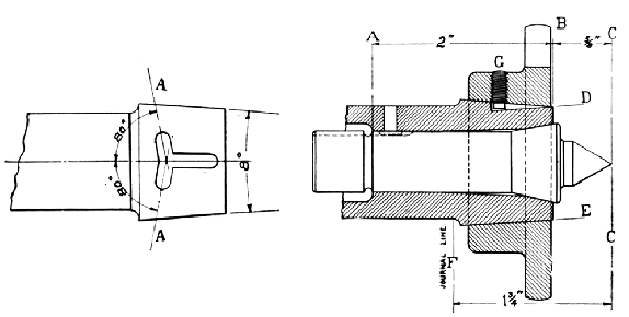

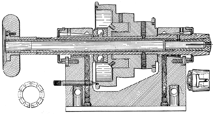

Patented headstock from the No. 3 lathe with a 0.625" spindle bore and (right) the novel spindle nose. Key to the designs success was to arrange the thrust ball bearings separately to the (rather ingenious) cast-iron sleeve bearings - these being tapered to allow for a very fine adjustment with the hardened and ground spindle.

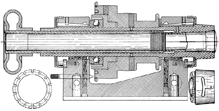

Headstock of the No. 4 lathe with a 0.75" spindle bore

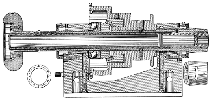

Headstock of the No. 5 lathe with a 1.21875" spindle bore
The patented Hardinge Taper-nose spindle fitting
The Hardinge spindle nose carrying a backplate-mounted chuck.
