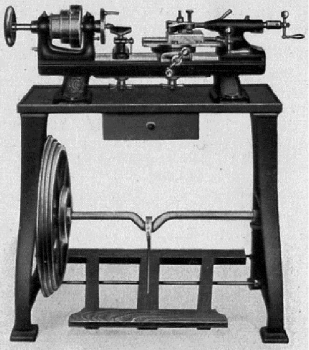

1920's Model D on treadle stand - sold as the Type DF

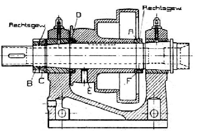

Standard, non-backgear headstock from the precision bench lathe
![](img14.gif) |
An early version of what was to become the well-known Carstens epicyclic reduction-geared headstock

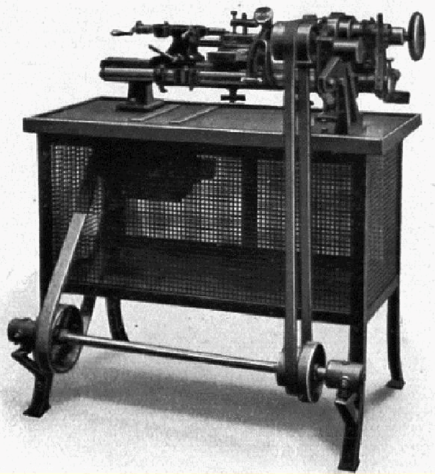

Although early lathes (see below) were offered for bench mounting - various stands were also listed that, besides the usual type of the era with cast-iron legs and wooden tool trays, also included some unusual examples made from angle iron with the faces sheeted in wire mesh. Early examples of the latter (as above) had the countershaft mounted externally, low at the back but (probably by the mid 1920s) this had been reposition rather more neatly to the inside. On the iron stands the top of the legs, where the contacted the lathe's feet, were hand scraped dead flat. Later models were supplied on either a particularly heavy cast-iron cabinet, formed in one piece for maximum rigidity and strength and intended for use on the shop floor, or on a lighter yet still strong stand rather like the earlier pattern (but improved in detail) and ideal for use in a toolroom.
