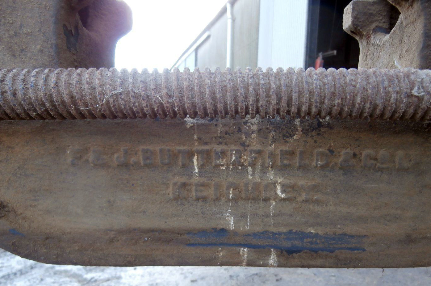

An English lathe, from Keighley in Yorkshire (once a centre of machine-tool production) the Butterfield was manufactured by F. & J. Butterfield Ltd. of the Midland Tool Works, a Company with its origins in a partnership of George Croft, Francis Butterfield, James Midgley, John Butterfield, George Wilkinson and Charles Brigg who traded as Croft, Butterfield & Co. Upon a reorganisation and dissolving of the partnership, this became, in 1863, Croft, Butterfield & Wilkinson before finally, from 1877, trading as F & J. Butterfield Ltd. - (Francis and John Butterfield) the two brothers being reported as taking on the debts of the previous concern (and perhaps starting afresh, possibly unencumbered by the financial interests on non-engineers).

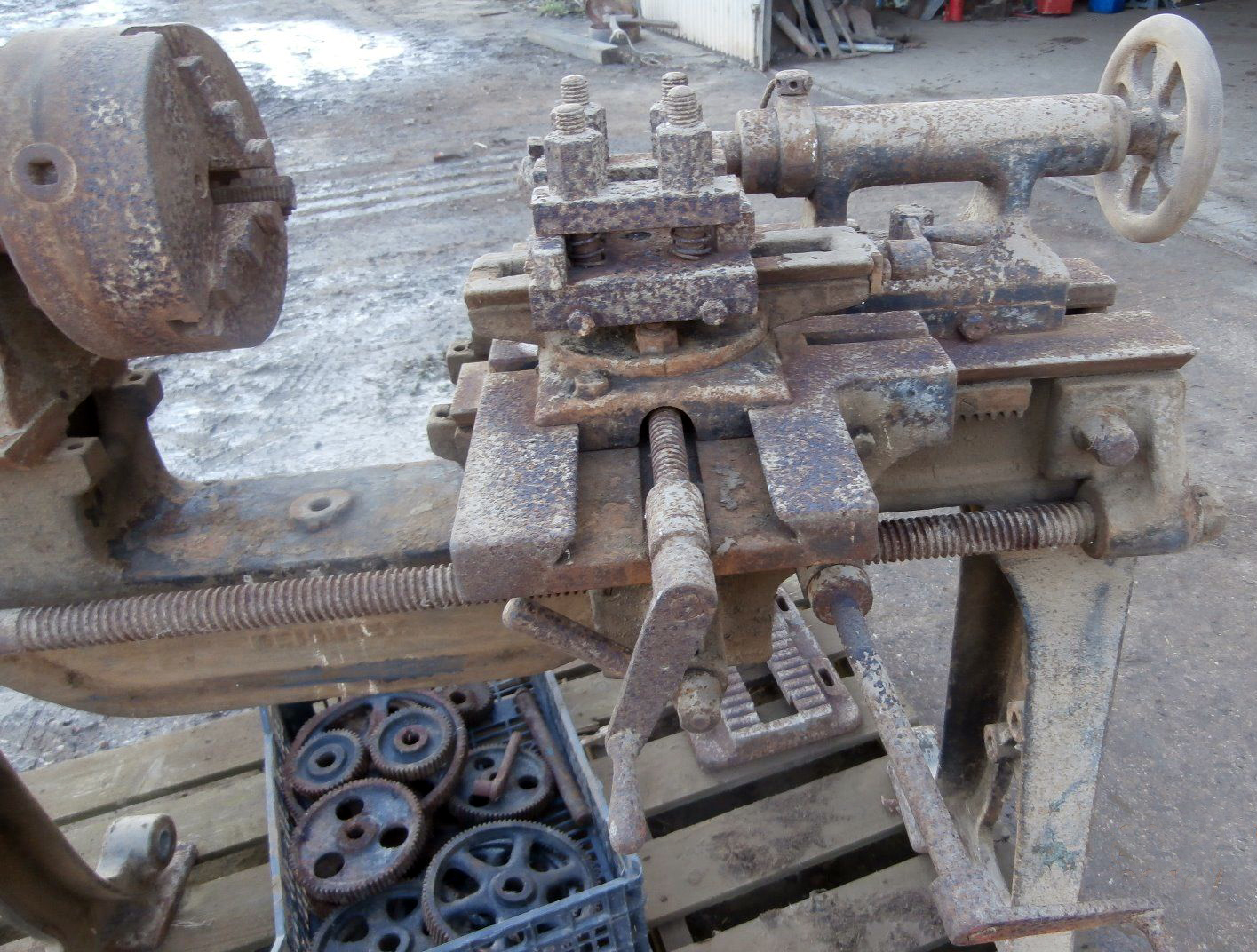

Both of the same type, two if the three known surviving Butterfield lathes are unusual in having a very deep gap positioned in the centre of their beds - and attempt, presumably, to offer a machine capable of tackling both ordinary work and very large faceplate-mounted jobs. To assist with the latter process, a double-reduction backgear* was fitted - lowering the bottom speed to between 5 and 10 r.p.m. - and the saddle extended well forwards to allow the cross slide to be drawn out and hence the tool able to reach the outside edge of the faceplate. In other respects the lathe was entirely conventional for its time  - circa 1860 to 1900 - with the carriage hand feed operated by a cranked lever operating directly onto a bed mounted rack (without the benefit of reduction gearing), a light tailstock with daylight beneath its barrel, a flat-topped 60-degree V-edged bed and a solid headstock spindle with its end thrust taken against a typical-for-the-time outboard pad.
Judging by the stand and its mounting for three support rollers on the inside of each leg, the lathe would have originally offered with the option of a treadle drive.

Recovered in late 2016 this double-backgeared Butterfield might just be in just-restorable condition
Happily, what appears to be a complete collection of screwcutting changewheels survive with the lathe
