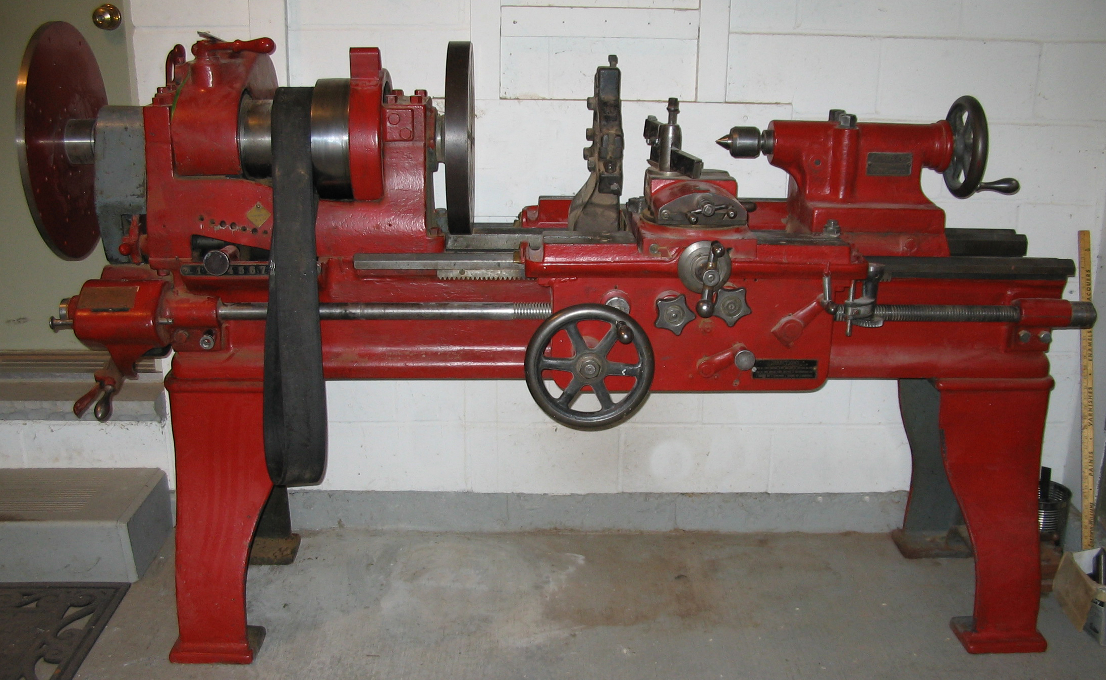

An earlier flat-belt drive Butler - the photograph below gives a better idea of its mass
