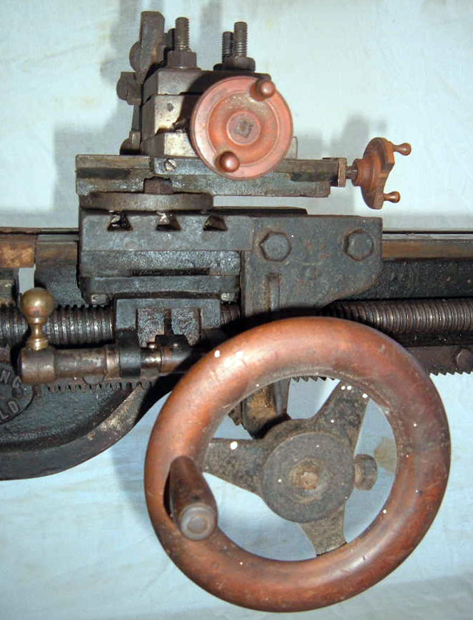

Otherwise forgotten, and with no trade references surviving, the  3.5" x 30" Bunting backgeared, screwcutting and gap bed lathe looks to have been constructed between 1870 and 1910. The outrigger spindle end-thrust bearing, the widely-spaced, lightly-constructed headstock bearings (in "boxes"), a perfunctory apron, coarse-pitch changewheels and backgears, the direct-to-rack carriage handwheel and "V" section slots in the saddle all confirm a machine of the mid to late Victorian era - though the relatively fine-pitch leadscrew would suggest towards the end rather than the beginning of the period. One interesting design detail was the use of handwheels with cast-iron spokes and wooden rims on carriage and leadscrew - and solid wooden wheels on the top and cross slides. The latter were set, as was common at the time, to work in a "cack-handed" way, that is, turning the screw "in" made the slide move "out" - this was fine when one became accustomed to the motion, but hopelessly dangerous when swapping back and forth to conventionally arranged machines. A handle fitted to the leadscrew end was unusual for a lathe of this size and vintage - though by fitting it at the headstock end, rather than at the tailstock, at least the designer gave the operator a chance of seeing what was happening to the cut as he operated the control. Arranged as a boring table with three "V" pattern slots, the front of the saddle carried a detachable compound slide rest with a typical English-pattern toolpost of the 4-bolt, single-plate type.

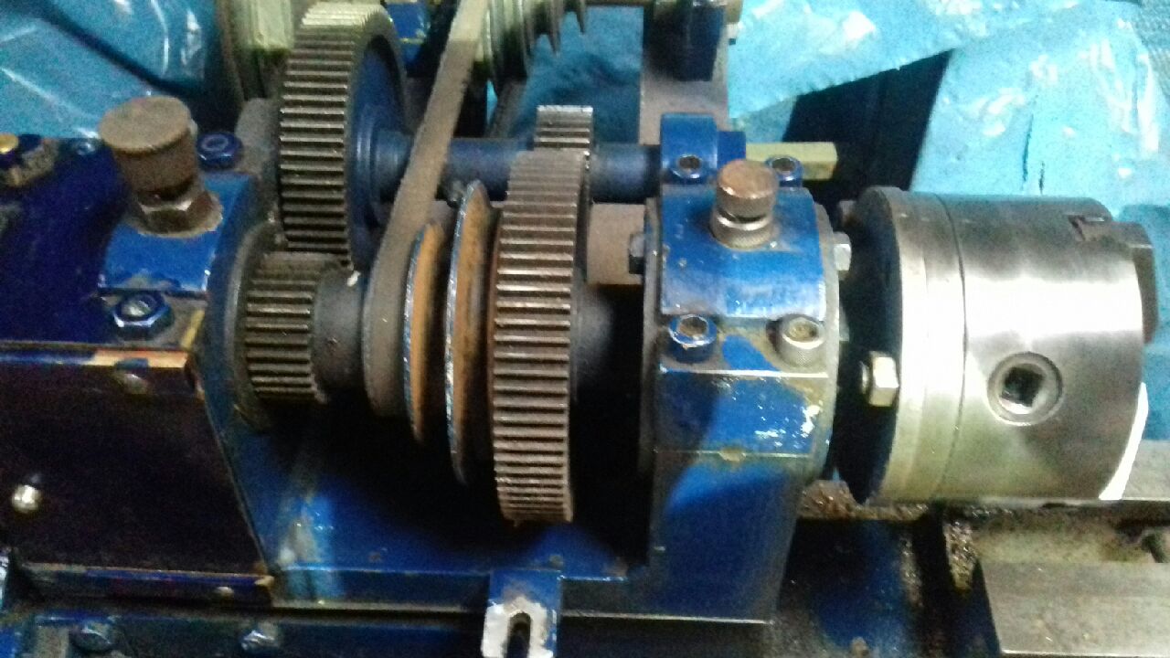

Only two more Buntings are known to survive, one a larger example (painted blue in the images below) that appears to have been modernised to some extent and still resident in Sheffield. If you have another, the writer, a native of Sheffield, would be interested to hear from you.
Has this Bunting been fitted with a different headstock and tailstock?
