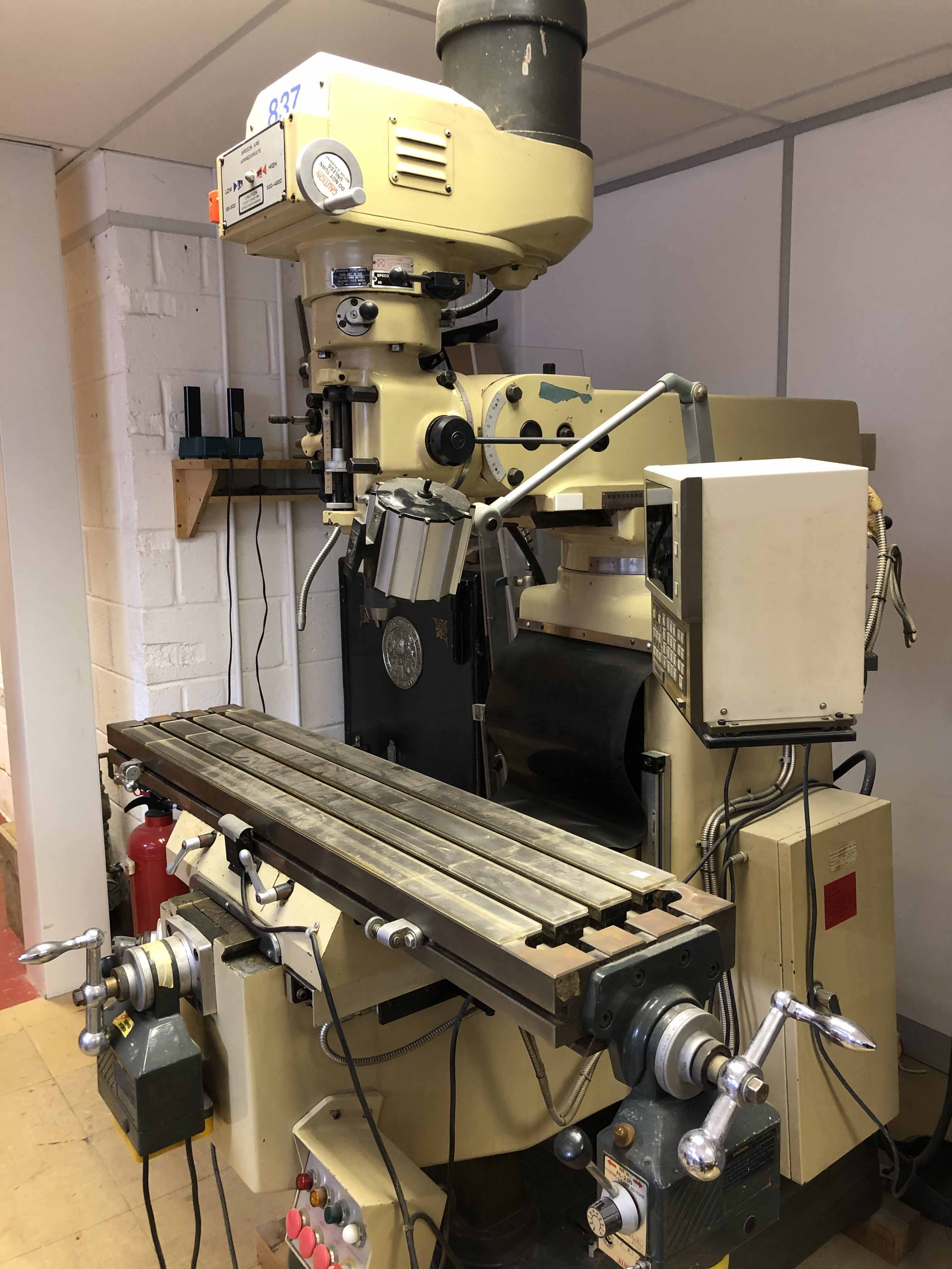

The Buffalo miller below might be for sale
