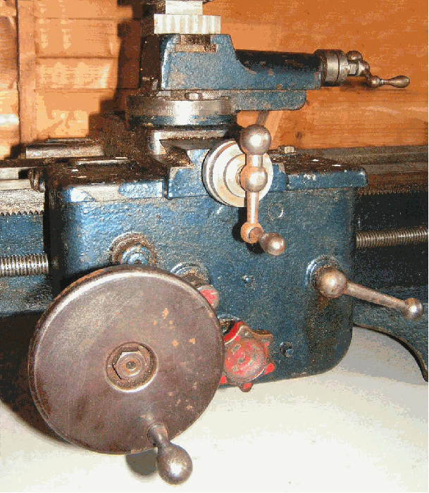

Looking otherwise identical to the American  Mk. 2 Clausing 100, the Broadway-badged BL624 lathe (as sold in Great Britain) used different bed feet and a full-circle carriage handwheel.

built to Schlesinger limits for toolroom or production work". In reality it is unlikely that the lathes were built to two different standards and the "precision" lathes would have been those that came through the post-build alignment tests with the 'highest scores'. Spindle speeds also differed from the Clausing being doubled in number to 12 and ranging from either 40 to 2350 r.p.m. or 45 to 2500 r.p.m. and the quick-change gearbox listed as having the ability to generate 48 inch pitches The stands were also unique with one incorporating a motor mount inside the left-hand cabinet leg. Technical details for the Broadway are identical to those for the Mk. 2 Clausing 100.
