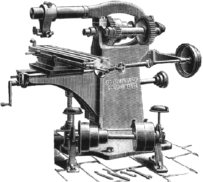

A Britannia publication is available - a wonderful 225 page technical book detailing the lathes and how to use them - with an emphasis on ornamental turning of which the author, J. Lukion B.A.,was an acknowledged expert. The back of the book has an additional and well-illustrated 194-page advertising section. In comparison with the great variety of types and sizes of lathe that Britannia offered, their milling machines appeared to have been few both in the type and number of variations offered. Typical of their vertical milling machines listed in the last years of the 19th century was the No. 14, a simply designed, modestly-sized affair with a 24" x 8.5" table power driven along the 18 inches of its longitudinal axis - but requiring hand feed on the 7.5-inches of cross feed, as well as on the generous 14 inches of vertical travel. None of the feed screws were fitted with micrometer dials. Because the belts driving the table feed were flat, and needed to go round rather small pulleys, a mechanism was devised that gave them the maximum amount of "wraparound" - and hence grip. The arrangement of the belts was, of necessity, rather a convoluted one and began with a small 3-step pulley mounted on a extension to the back of the horizontal drive spindle; this drove down to a matching pulley carried in a bracket at floor level to the rear of the main column. From there the drive was carried forwards to a system of three parallel pulleys - around which the final drive belt must have been wrapped - and hence to the small pulley and its attached worm gear at table level. Echoing Britannia lathe practice, the miller's 1.625-inch diameter vertical spindle had an adjustable thrust plate supported outboard on two columns; unfortunately, this type of arrangement precluded the fitting of cutters held in place with a draw bar - the spindle being blocked at the end and unable to be bored clear through. The spindle carried a 4-step cone pulley, driven by a 2.25" wide flat belt, with a largest diameter of 8.5 inches - and a smallest of 3.75 inches. A lathe-like backgear assembly was fitted, greatly increasing the capacity for heavy, slow work, whilst the head of the machine was braced by a cast-in overarm. The large hole through the centre of the machine's body was to accommodate extra long workpieces - a useful facility that allowed the miller to tackle jobs that might otherwise have demanded the use of a much larger and more-expensive-to-operate machine..
Britannia No. 14 Vertical Miller

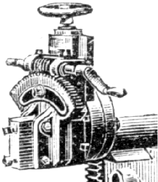

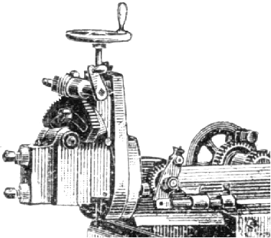

Britannia shapers, even the smaller models, were industrial-class machines and fitted with many features designed to enhance both their speed of working and versatility. The 1.25 ton, 12-inch stroke No. 33 machine, illustrated above, had a 16 inch by 14.5" table with 6 closely-spaced T slots machined in the top (and a T-slotted right-hand vertical surface) that could be traversed a total distance of 24 inches from side to side under either hand or power feed. The ram was fitted with a rack on its underside and driven directly from a large-diameter gear beneath. The toolholder not only swivelled on the end of the ram - as was normal - but was also fitted with an ingeniously-designed power feed, operated through a ratchet mechanism tripped by a rod fastened to the side of the ram; the details are just visible in the picture below. In addition the toolbox was fitted with worm-and-quadrant gearing that allowed it to be independently tilted and so aid, so the makers claimed, the process of shaping "internal curves". The worm could be released from the wheel, and quickly reset to its original position. In order to support longer jobs, which may have hung off the table, a bracketed roller support was provided that could be placed at either side of the table. Although heavily built - it weighed just under half a ton, the machine was not as rigid as it might have been; the two supporting legs were separate castings, and not joined at floor level - if they had been, and extended forwards, the table could have been given a (sliding) support under its front edge to resist the bending action of the ram when it was being used to the limit of its longest stroke.
Britannia No. 33 shaper with Worm-and-quadrant gearing on the toolbox - and a rod and ratchet activated power feed to the tool slide.
