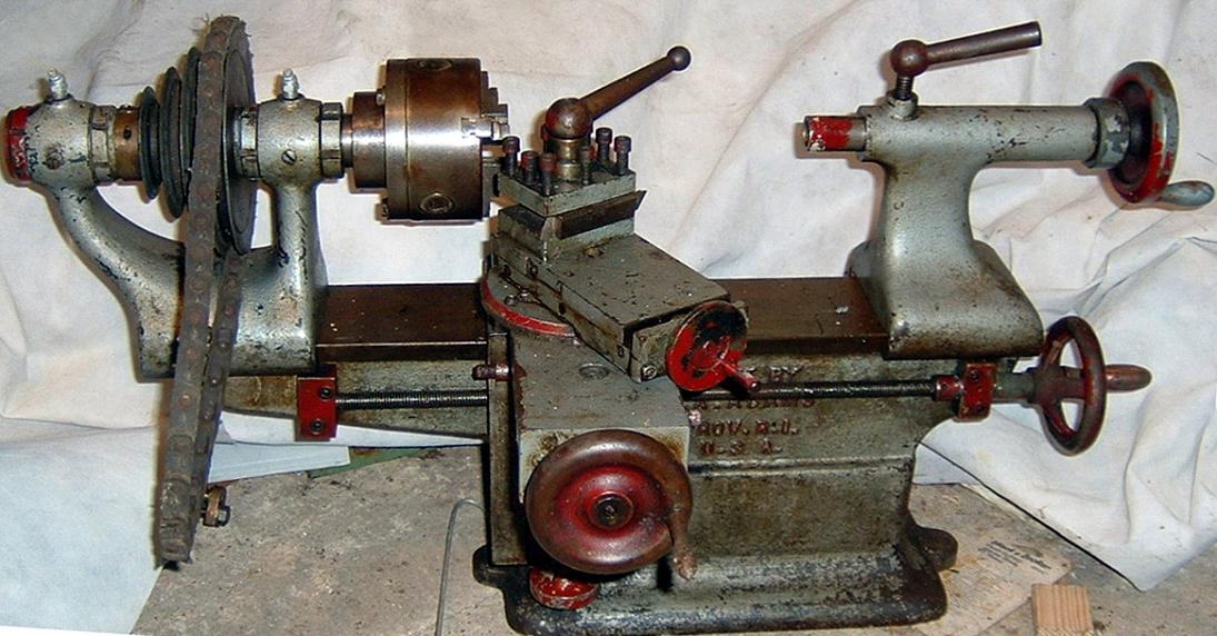

Very similar in appearance to the
E. A. Adams, Providence, Rhode Island, and the E. A. Eddy, Providence Rhode Island, the Bosworth was of approximately 4-inch centre height and 10-inches between centres. It had neither backgear nor screwcutting and the wide, flat-topped V-edged bed (made from good-sized box-section casting) carried a single lever-action cross slide driven through a toggle mechanism. Interestingly, the E.A.Adams had a proper compound slide rest and its entirely possible that this was an option on the Bosworth, a hole being provided through the saddle casting to take a cross-feed screw.
Unlike the unusual E. A. Adams (which may, in any case, have been modified) the Bosworth was arranged conventionally with the main mass of the bed under the headstock and carriage and the tailstock end cantilevered out to the right.
With just two wide steps on its cone pulley, the headstock looks to have been constructed for industrial use, this arrangement being common on lighter and
bench precision lathes of the time- a similar 2-step arrangement being used on the headstocks of the W.H.Nichols and (three-bearing) Ames type. Threaded on their ends for adjustment and drawn down into their tapered seats by large ring nuts, both headstock bearings were mounted in a light casting with that on the left held on the end of a slender arm cantilevered out to the left and that on the right on top of a short, un-braced vertical post.
It appears inconvertible that, as all three lathes appear to be identical in both layout and detailing and come from the same area, all must be by the same makers and badged, as required, by the customer for sale into the trade.

The E.A.Adams (Providence, Rhode Island) version of the lathe
The E.A.Eddy (Providence Rhode Island) version of the lathe
