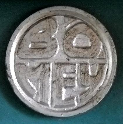

Some lathes had EKS on their bed foot, others Bomey
