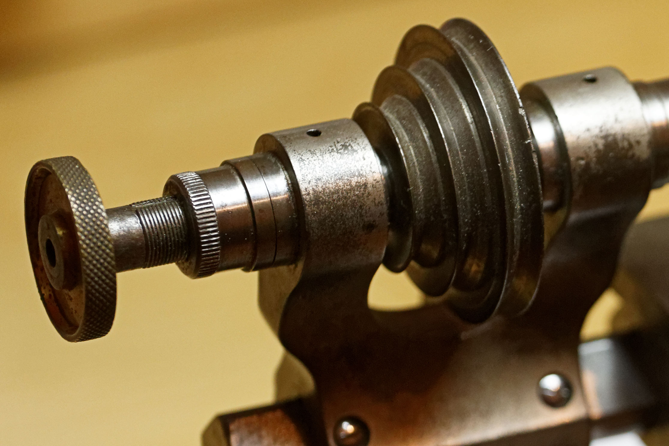

Like the Boley (and many other lathes of this type) the Telco had the face of its largest headstock pulley drilled with 4 rings of holes and a spring-loaded indent arm that allowed the spindle to be indexed though a large number of divisions.

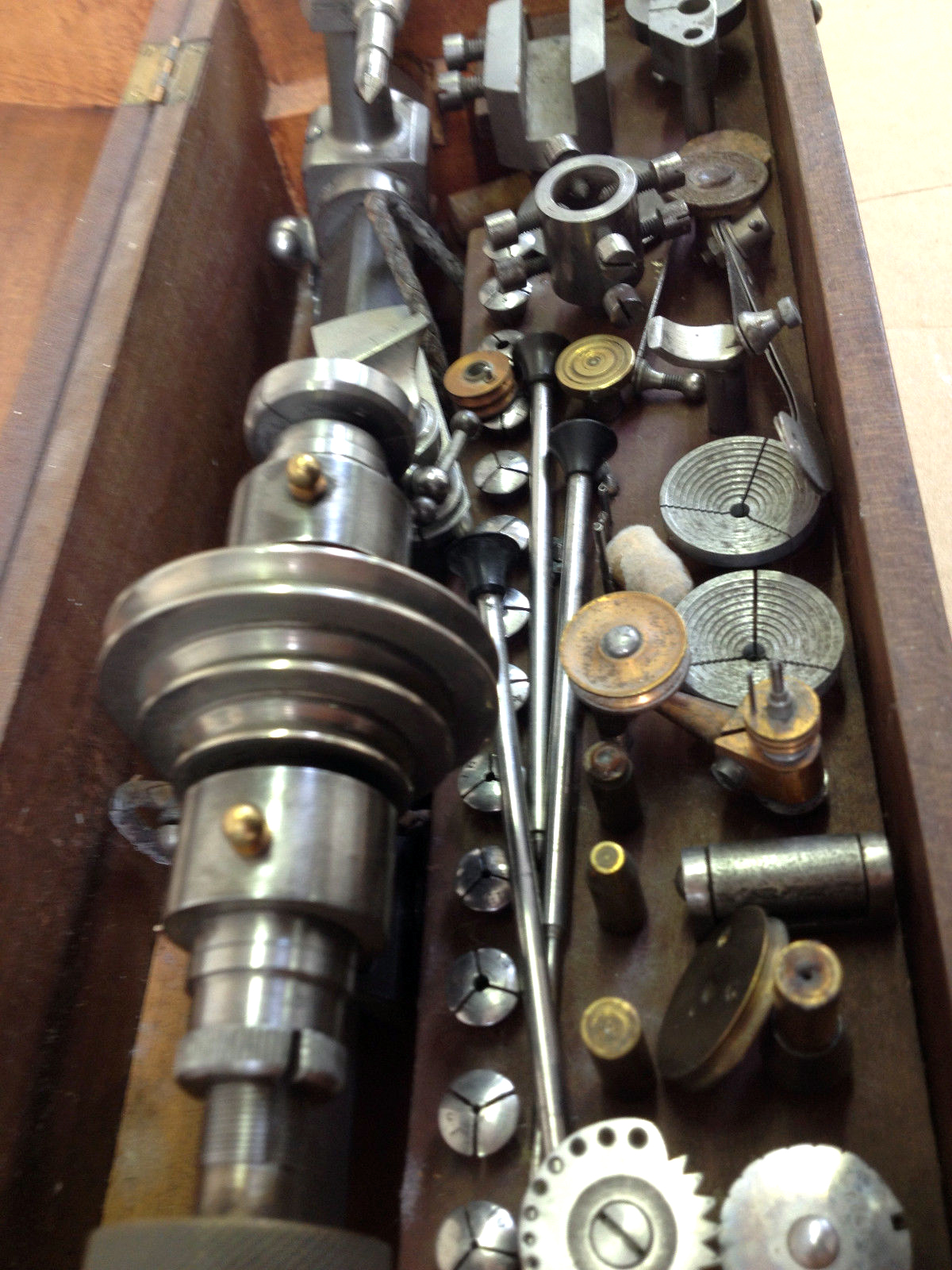

A rare survivor - a Telco complete in its fitted box with a good range of accessories
