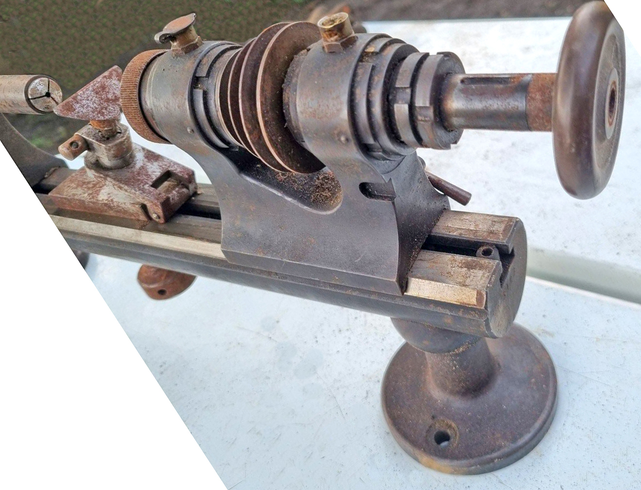

A previously unknown maker, this "Boidon" lathe was found in England - though where it was made is not known. Like most of its type, the centre height would have been between 3.5 and 4 inches and the capacity between centres from 15 to 20 inches. Dating this class of lathe is not easy, for many remained largely unchanged over several decades, though in this case, as the headstock spindle was fitted with a 3-step, V-belt pulley, it must have been made post-1930, the date when this type of belt first became widely available. The appearance of the Boidon does not remind the writer of any other make, and while a previous owner might have applied the badge, its odd name and the spacing of the distorted letters suggest that the manufacturer applied it.
