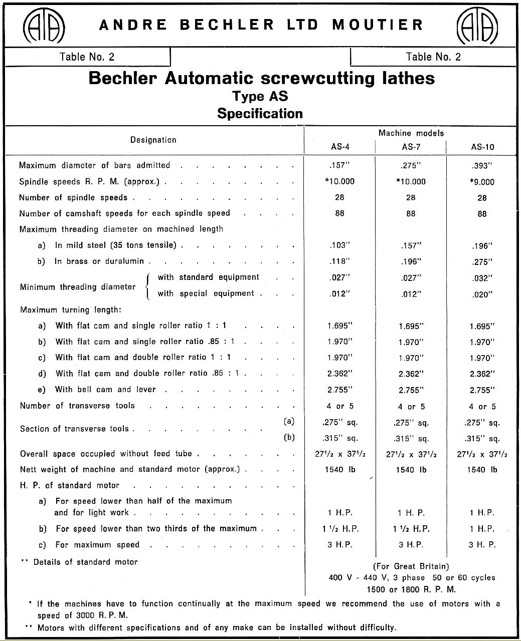

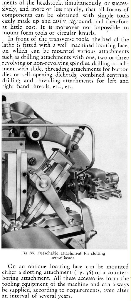

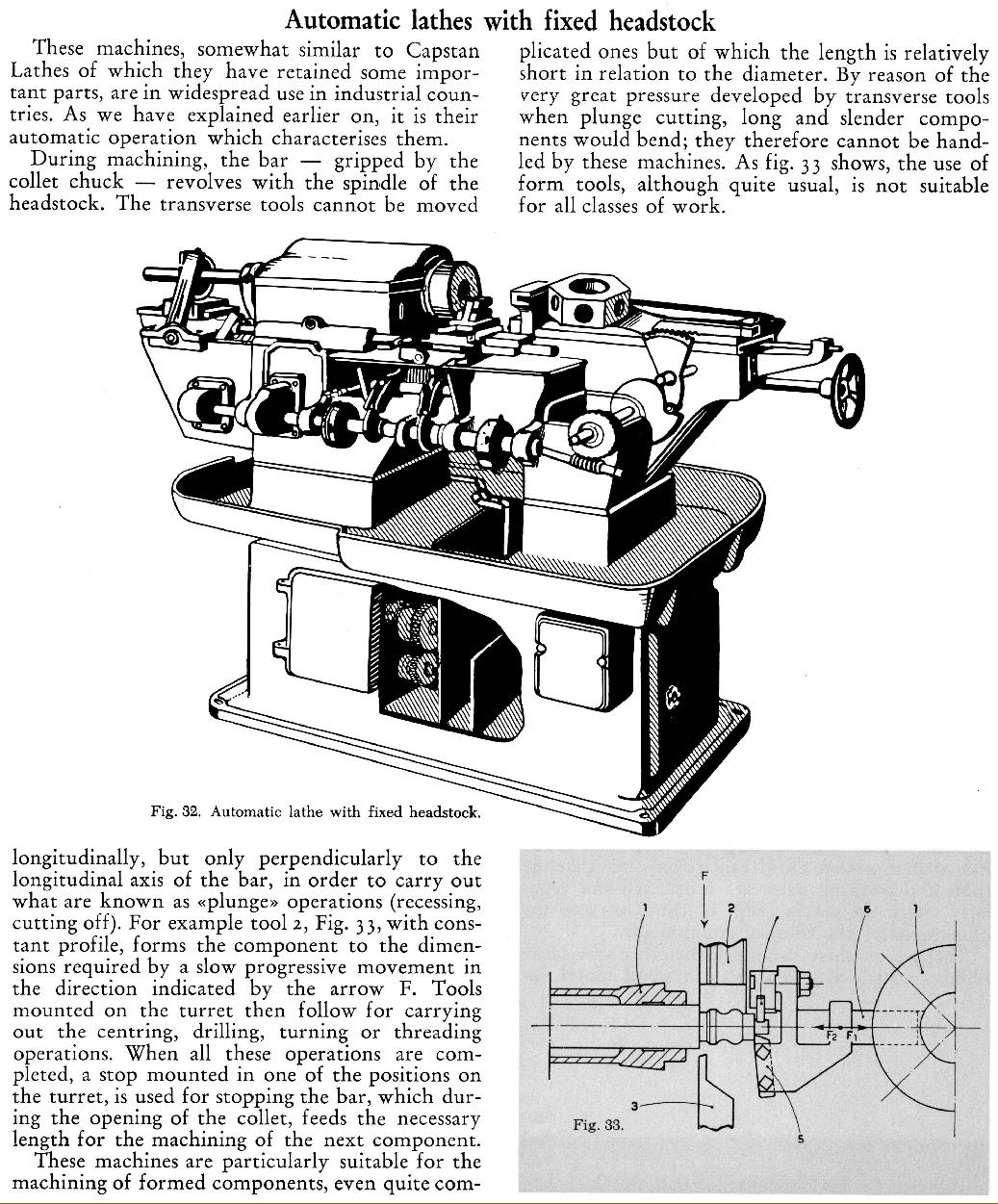

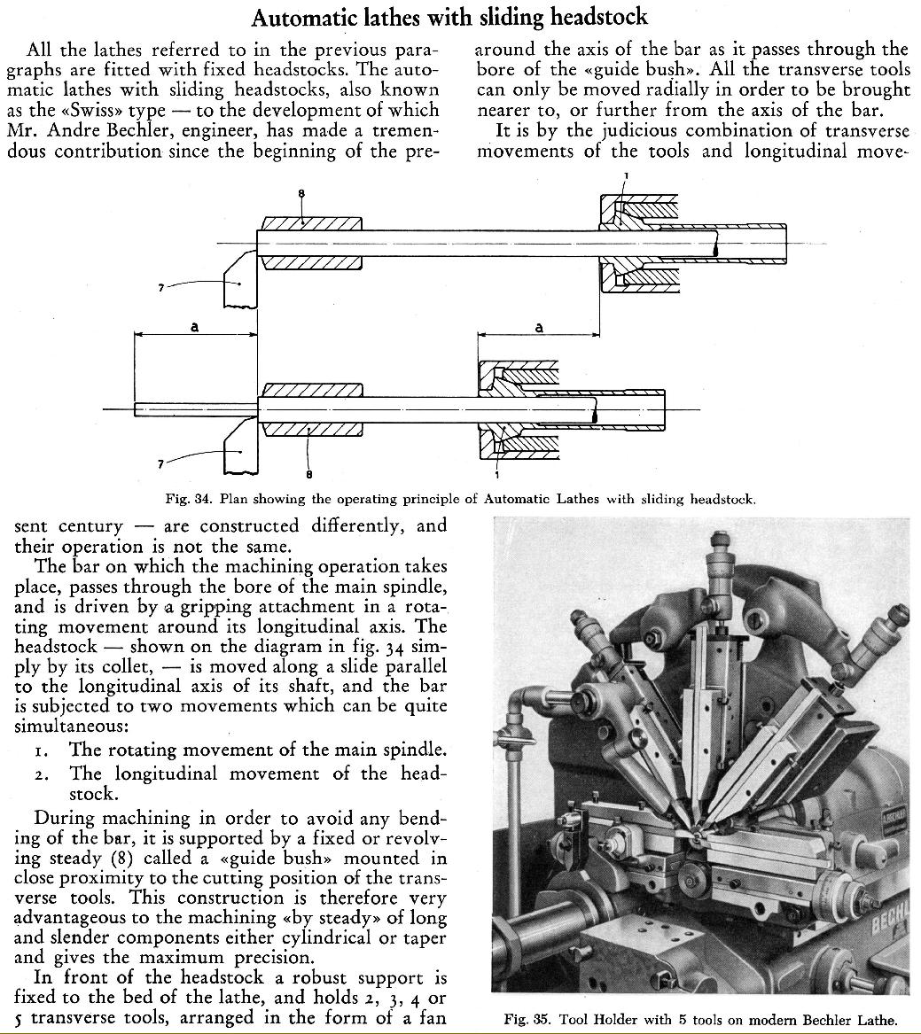

Now adapted to computer control both the Swiss Auto and single spindle automatic are unsurprisingly, still being built by numerous makers worldwide (Japan having considerable success in the field) - a term often used for this trade is the "Bar-turning Industry". Below and on the following pages are extracts from a wonderfully detailed general instruction book on Swiss Automatics that covers a host of subjects including the Company's background and the design and development of the lathes, their intricate mechanisms, accessories, metallurgy, tooling, cam design - and how to use them efficiently and profitably. The book even includes a selection of cartoonss that advises on operational procedures and dispense mechanical homilies - all to aid the worker in his quest for increased production while maintaining a very low rate of quality rejection..
