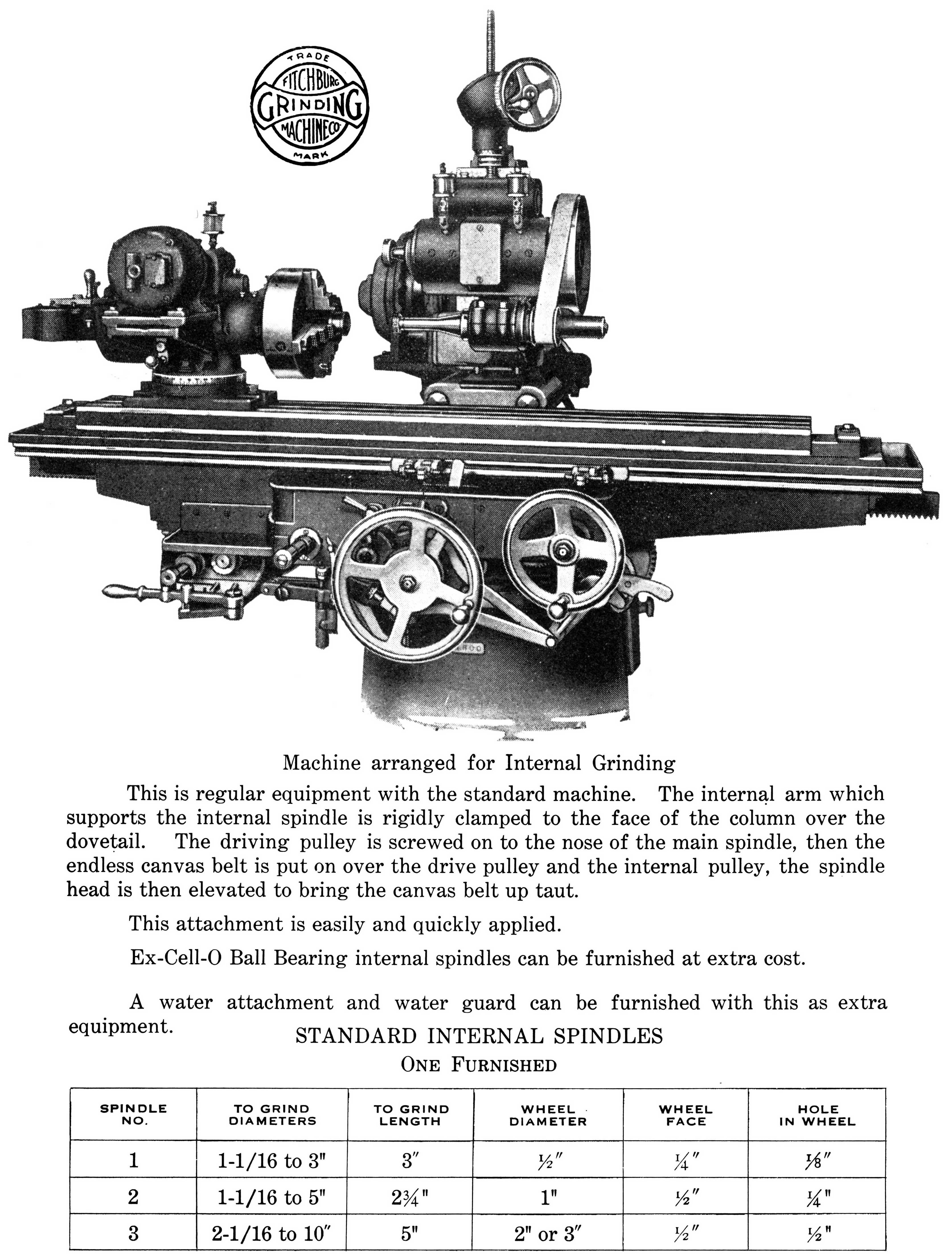

Dating from the early 1900s, the "Bath" was able to perform external, internal, surface and tool and tool cutter grinding. With the addition of extra-cost accessories it could also tackle gear cutter work, inserted tooth cutter grinding, and knife grinding.
The machine appeared at a time when more and more machine tools were being equipped with self-contained motor drives; extrapolating from the maker's text, earlier versions were also manufactured with some of these almost certainly having drive from some form of remote countershaft of overhead line shafting.
Over the decades many similar models have been made, these ending up as very much more robust machines such as the range made by Jones and Shipman and K.O.Lee.
