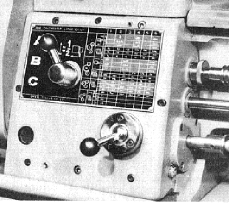

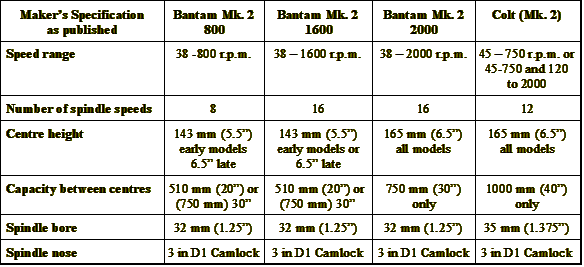

Continued: Usually found badged as a "Bantam 1600", but also available with top speeds of 800 and 2000 rpm, the Mk. 2 Bantam can be recognised instantly by the "gated" screwcutting gearbox control lever positioned in the bottom right-hand corner of the headstock's front face. A special version, designated as the "Colt", was also produced during the 1980s. This was a machine with the centre height increased to 6.5 inches, a remarkable 40 inches (1000 mm) between centres and a choice of a single-speed range from 45 to 750 r.p.m or (with double-step pulleys on motor and input shaft) two ranges of 40 to 750 r.p.m. and 120 to 2000 r.p.m. Both inch and metric screwcutting was available with a leadscrew of 4 t.p.i. on the former and 6 mm pitch on the latter. The standard-fit gearbox on the Colt was, unaccountably, different to that on the contemporary Bantam and instead used the distinctive joystick control lever from a Mk. 1. In the last years of production only Bantam 2000 with an increased centre height (6.5 inches) and a top speed of 2000 rpm were offered - but these machines should not be confused with the completely different Mk. 3 Bantam - and which was actually a Harrison M250. All versions of the Mk. 2 Bantam had a useful 1.125-inch spindle bore, 0.25" greater in diameter than the earlier model.

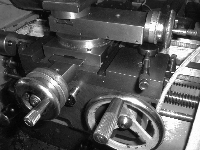

Above and below: the apron as used, respectively, on the Bantam Mk. 1 and Mk 2 Bantam. Only the handwheel differed
For a 5-inch the lathe the carriage was noticeably robust

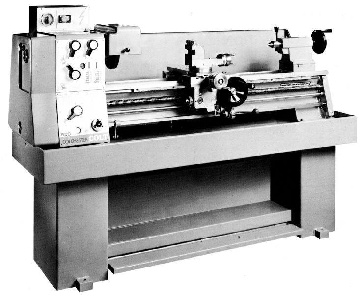

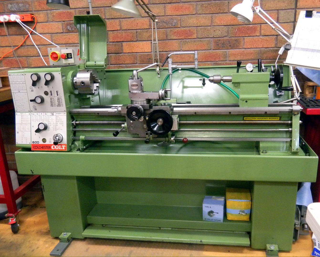

A rare long-bed, Bantam-based "Colt" from the 1980s. The "600" badge on the facia panel is not a model number but refers to the "600 Group" of engineering companies. An even rarer "Vari-speed" Colt was also produced, as was a version labelled "Spartan 330" - a machine sold by the 600 Group in South Africa

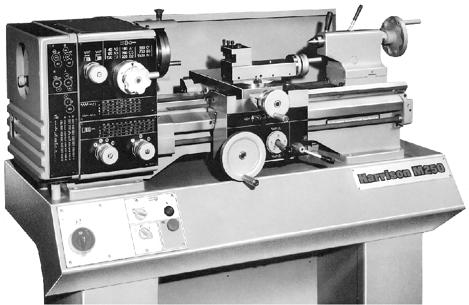

Harrison M250 - the colour scheme and the shapes and disposition of some controls may differ, but this machine was also marketed as the Bantam (Mk. 3) 2000.
Bantam 2000 Mk. 3 - which was really just a lightly-modified Harrison M250. This model of Bantam can be quickly recognised by the all-dial selectors on the screwcutting gearbox.
The notes below apply to the Harrison M250, but are also largely applicable to the Mk. 3 Bantam: With a 145 mm (5.7") centre height, the Mk. 3 Bantam was designed to appeal to schools, training establishments, repair shops and those needing a compact lathe for light production work; as a second-hand machine it is relatively rare on the used market with prices driven high by demand not only from small professional workshops but also the more enthusiastic home user. It was available with a choice of either 500 mm or 750 mm (20" or 30") between-centres and had an induction-hardened bed as standard - but lacked the option of a detachable gap; interestingly, the width of the bed, at 190 mm over the ways, was greater than the centre height, a design feature that not many years ago would only have been considered necessary for a lathe built to "toolroom" standards. Early models had 9 speeds from 40 to 1500 rpm (or, optionally, 80 to 3000) whilst the later models (1998 on, approximately) ran from 52 to 2000 rpm - the electric motor used on the slower model was 0.9 kW, with a 1.3 kW employed to drive the faster machines. Fitted with a hardened and ground No. 3 D1 Camlock nose, the 35 mm (1.3") bore No. 5-Morse taper spindle ran on Gamet Super-precision bearings; the headstock gears and bearings were lubricated by oil splash. Able to be ordered as either a metric or inch unit, the screwcutting gearbox could be fitted with both types of translation gear. The two standard gearboxes - which gave either 33 inch pitches from 3 to 72 t.p.i. or 33 metric pitches from 0.25 to 8 mm - were provided with an oil supply, circulated by splash from the lower gears dipping into the lubricant and flinging it around. The carriage, fitted with European Safety-Neurosis handles with full, smooth faces was driven by both a fully guarded, 25 mm diameter leadscrew (in 6 mm or 4 t.p.i pitch) and a power-shaft; the leadscrew was used exclusively for screwcutting whilst the torque-limiter-protected powershaft provided the sliding and surfacing feeds for normal use. Although the top slide had a traditional, parallel-type of screw-adjusted gib strip, the cross slide was fitted with the superior tapered type, able to be set more accurately and provide much better support; both the cross and top slides, as well as the saddle, were fitted with locking screws. A final development of the Bantam Mk. 3/Harrison M250 was the variable speed VS3500, a lathe probably intended, in the eyes of the marketing department, to be a lower-cost alternative to the superb but expensive-to-construct, long-lived though obsolete Chipmaster. Details of the VS3500 can be found here..
1984 Colchester Colt 2000
Colchester Colt with the makers tailstock-mounted capstan unit Continued here
